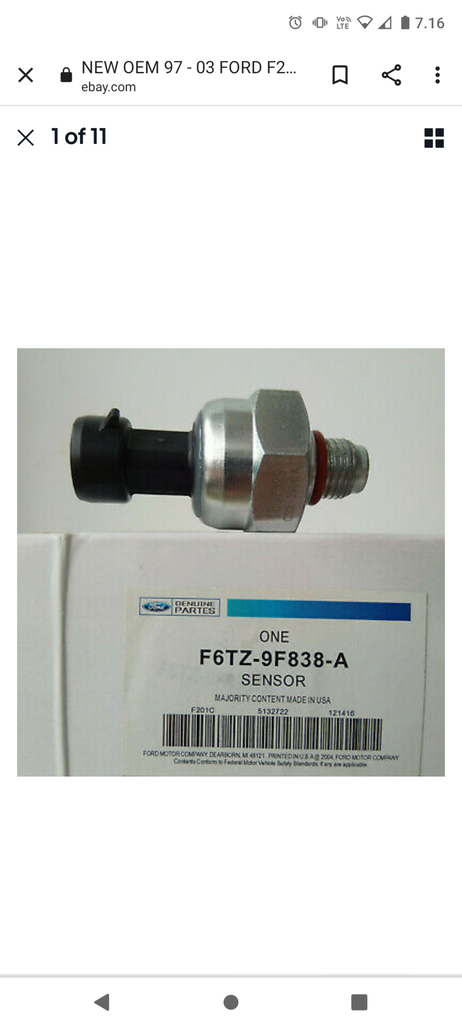

Those do look like the original hpop lines. Just a heads up those aftermarket ICP sensors are known to cause a lot of problems.
eeeek!! I didn’t know that was an aftermarket ICP, I figured it was the original old style....

That ICP sensor is original OEM.
All new sensors has big nut on them(even Motorcraft etc.)
Factory sensor has completely round body and small nut underneath.
I still had a factory ICP sensor when i did my injectors at 503k miles.

Thanks for setting it straight I had honestly not ever seen one like that so thought it was aftermarket. OP you might want to hang on to that one
so if ICP tests ok and shows me correct pressure should I consider installing a new one? Just because of age?
Hahaha I’m going to have to now, $1900 bucks! Why so much!? that has to be a typo or something

Maybe that's pesos. If I remember correctly you are getting a ICP code but there is a lot of different things that can cause that. Maybe those ICP sensors are like gold, kind of like the original black CPS sensors that are really hard to find nowadays. If anything you can always unplug the ICP sensor to get it running after you clean the IPR and see if there's any change in idle plugged in versus unplugged. If Finnish's ICP went to 500,000 mi I would say those are probably better than the new ones. Maybe Finnish can shed some light on this.
It's seems to be reading pressure so should be ok. Have you checked for any oil in the ICP plug?
