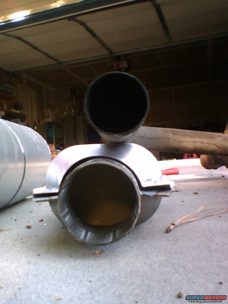

Stock was a 2" pipe.
This is my 2.5" exhaust compared to the stock 2" exhaust that I cut off
