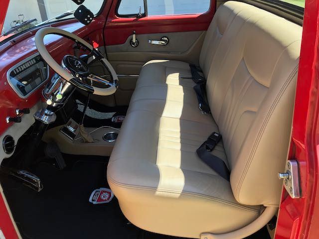

This is mine. The way it is it works great. If I were to do it again I would make a couple of enhancements: add a place for a cell phone to sit and I would probably stagger the drink holders a little.

I believe my seat came from a 1997 F150. When I had the seats recovered, I decided to have the headrests shaved and the "bucket" of the seat on both sides moved inward. By doing this, i was able to remove some of the cushion overhang on each side which shortened the overall length of the seat. More importantly, the "bucket" of the seat where my backside is positioned is now aligned with the position of the steering wheel.
