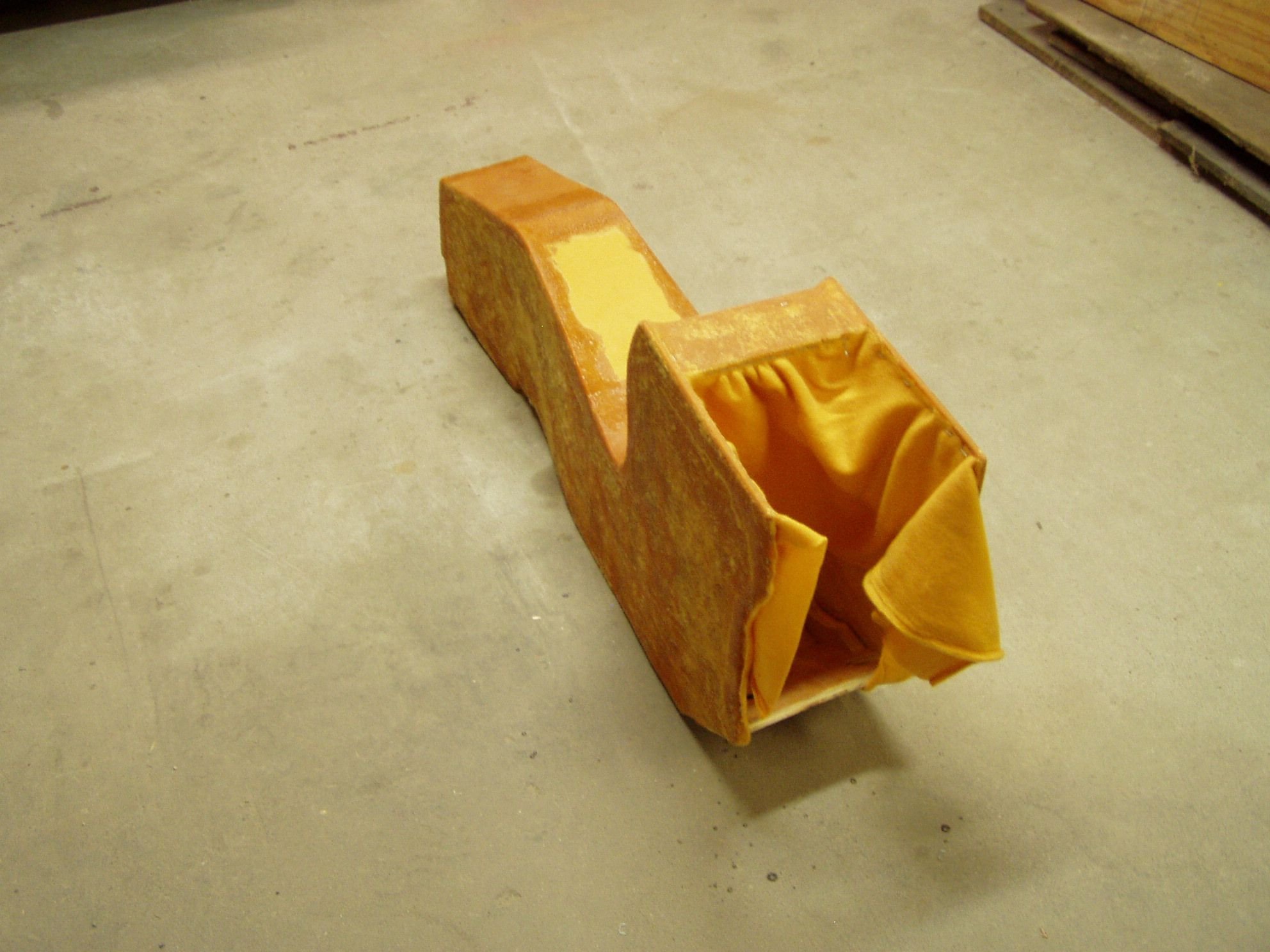

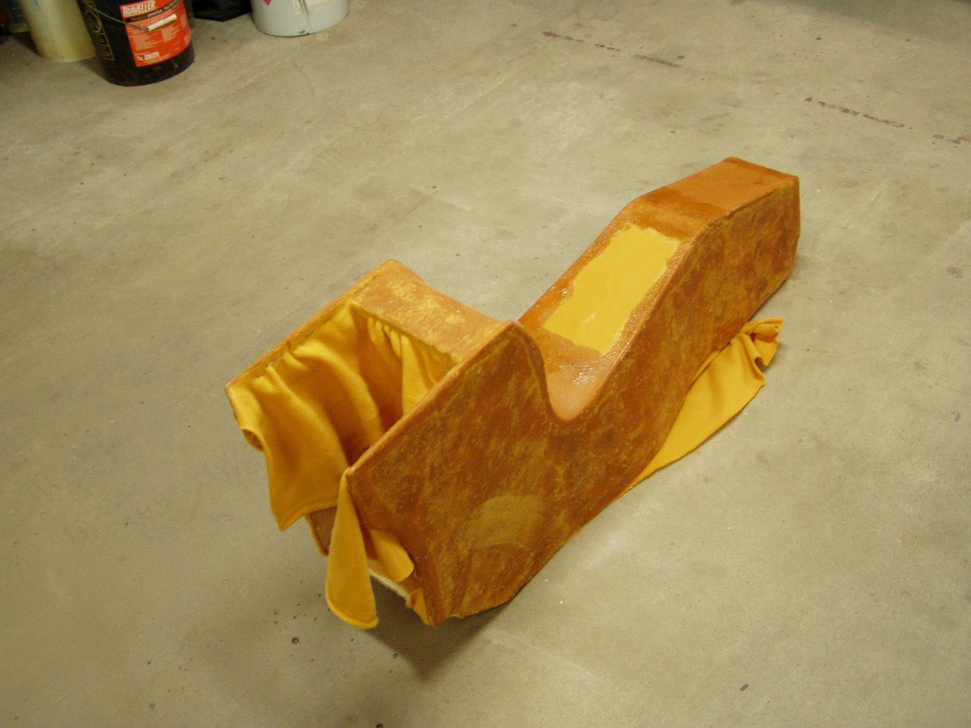

Moving right along........I guess I must have walked through the tuner section one time too many at the local cruise in....... cause I got the sudden urge to run to Wallyworld and buy a yard of the cheapest fleece I could find. $2.97 a yard got some designer orange and headed home. Lots of staple later stretching the fleece and around 30 ounces of polyester resin and the console is covered and ready for some mat placed in strategic locations. No resin where there will be a cutout for the shifter.
You will also notice that I made a change in the rear of the console. Haven't had a chance yet to cut off the excess fleece.
I'm really surprised how light the console has remained so far.
More to come if and when I figure out what the heck I'm gonna do next.
