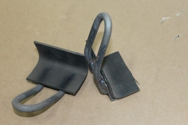

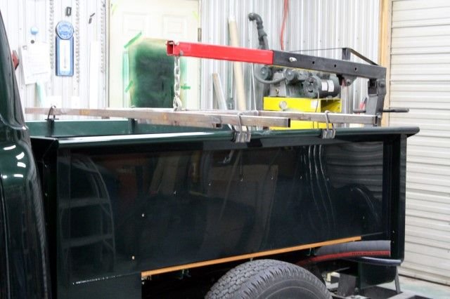

Yea John, that's how I put it on !! I got a 800# 120 volt hoist for Christmas and am in the fabrication stage of building the mounts under my lean too to hang it.. Plan is to back the truck out of the shop and under the lean too...lift off the bed then roll the truck back in to do the rear end work... the bed will be lowered onto my bed dolly till the work is complete then reverse the plan... John, I'd like to see your bed rail "clamps" up close up if you have a picture or two

Not sure if I have any pics now but can take some tomorrow. All they are is pieces of angle iron with a loop of 3/8" round rod welded to them with a slight bend to make it hook under the rails and rubber glued to them to protect the paint..

All this lifting stuff is theory...but it sounds doable. Canada John was going to get me some pics of his bed lifting clamps (see above)so if that's easier I might make some and lift it from
the bed sides instead of the mounting holes

are your clamps welded to the two cross bars ?? and it looks like the front and rear bar have a spreader like an "H" ??

The lifting clamps just slide over the bars so they can be used on just about any box. There is an " H " welded between the two long bars and gets lifted from that. This picture might show it a little better
