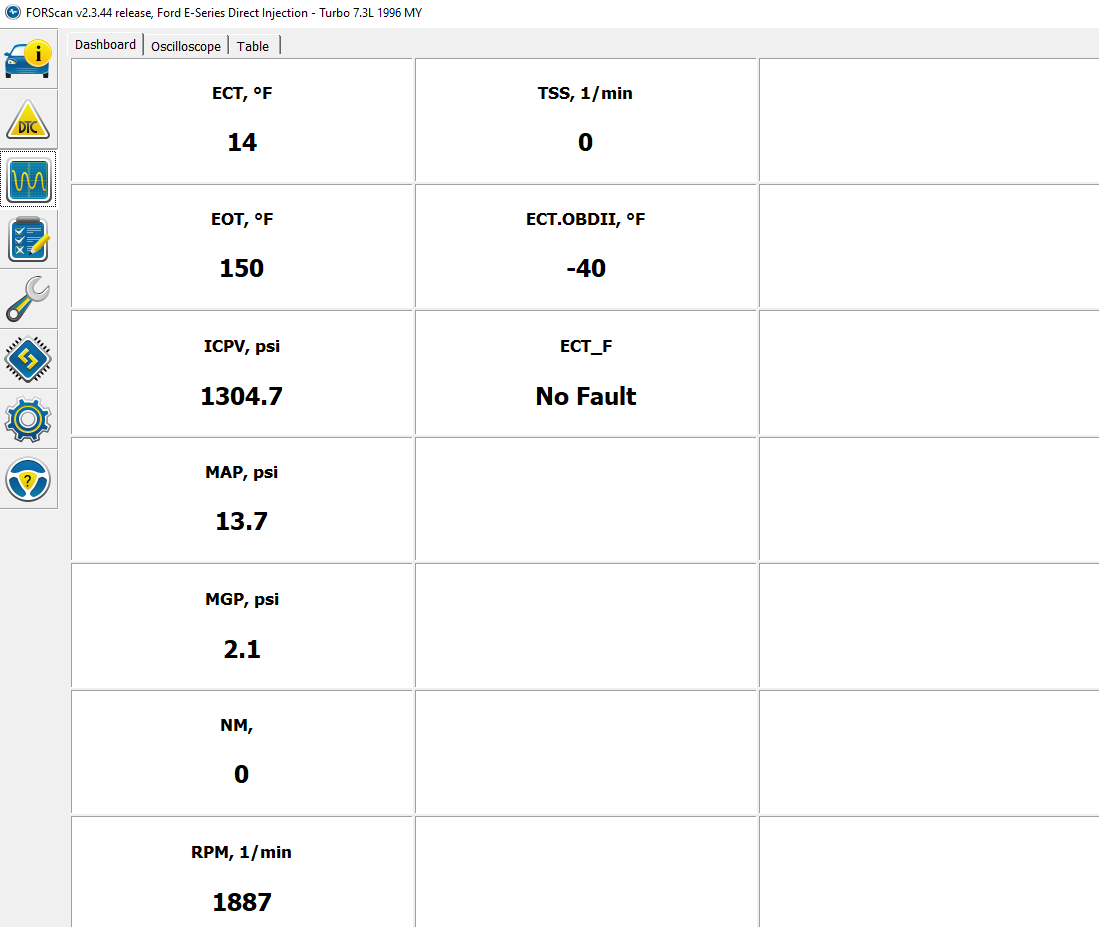

The closest thing I could find to reading the turbo boost psi, is the MAP psi sensor reading. Is that at least in the ballpark of what I could expect the boost to read if I wired up a proper lead and gauge?
On my bone stock '96 I noticed the MAP reading ranges from 11-14 psi generally, which seems on par with the output of the stock turbos. I am in Colorado at about 7k feet.

Yes, the manifold absolute pressure (MAP) sensor is where the computer gets the boost reference.

Manifold Absolute Pressure (MAP) includes barometric pressure in addition to boost pressure. To read just turbo boost, use the MGP PID in FORScan. MGP = Manifold Gauge Pressure.
More info in the FORScan how-to thread on PIDs that work for our trucks below:
https://www.ford-trucks.com/forums/1...de-thread.html

Interesting, I must have missed that one, will look for it the next time I get things hooked up, thanks.

Yep MGP was the one I was missing, thanks!
After I added it, I saw about 2psi while running steady at 60MPH at just under 2k RPM:
And then 12psi at near WOT starting at around 40MPH:
So the MAP is definitely atmospheric PLUS boost, MGP is only boost. I was starting to think there was no way to easily read boost on these older trucks, so that's great that it's available.
