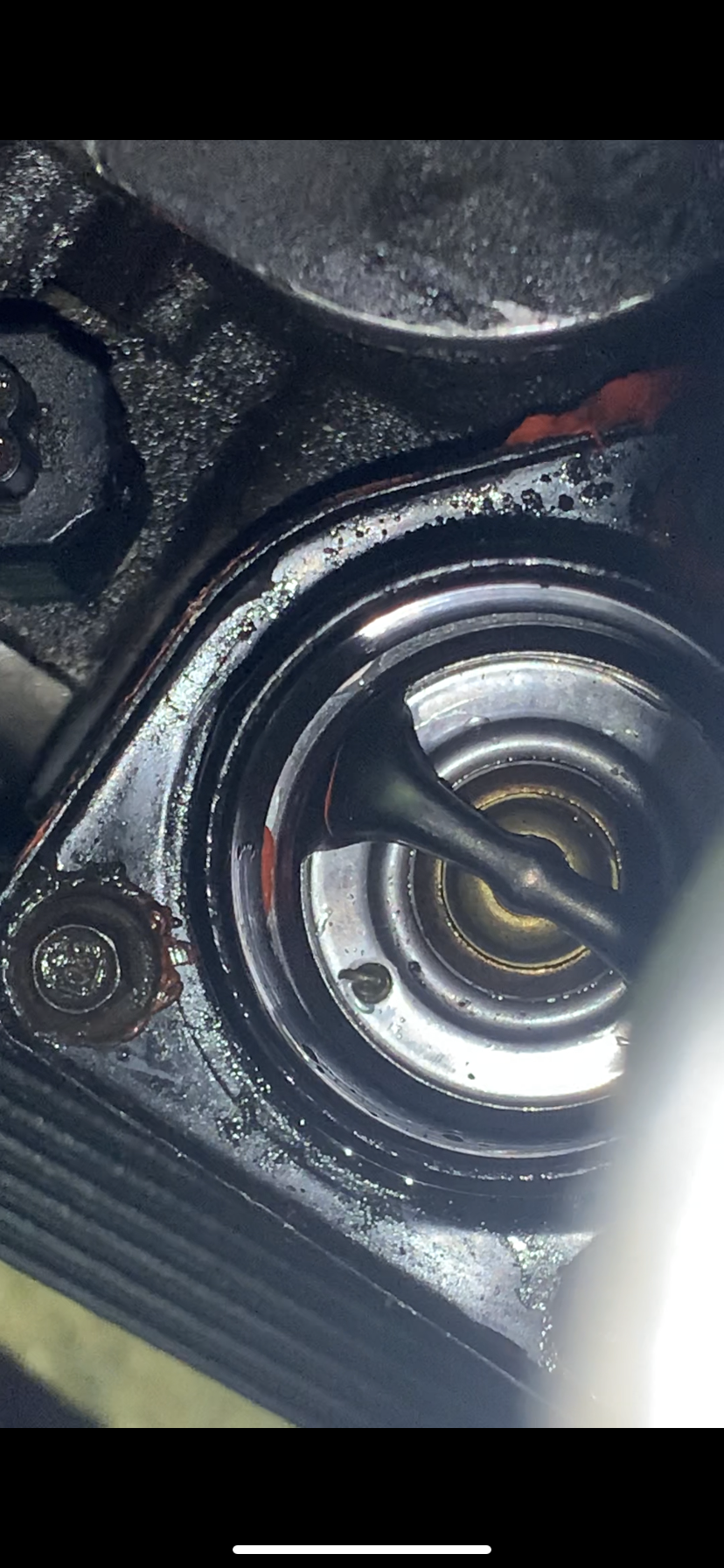

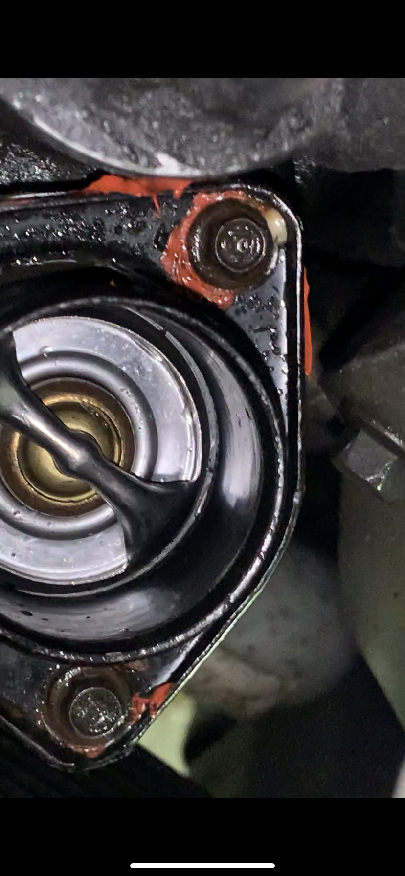

I put an oreilly motorad brand 192 stat in.
it wouldn’t seal with the new housing and gasket so I put a bit of rtv around it.
i can already notice a huge difference. My heater blows out warm air and the truck has way more horse and torque readily available..
But if you guys think I should go get a motor craft oem 203 stat I will but I love it already.
The truck has been running for 5 years on an open thermostat...

I would also vote for a Motorcraft thermostat and billet cover. DONT use RTV, it breaks loose and clogs your oil cooler.

The main advantage of the Motorcraft version is that it has a much better built in sealing gasket that doesn't leak at all, and the billet aluminum housings are a must have also to keep the rust and crud away. As far as the temperate ratings I didn't much difference between stock and the 203. Far more important is that it's a quality part that works correctly so OEM is the best bet here.

Correct,stamped thermostat housing most likely has sealing issues due to the warping.
