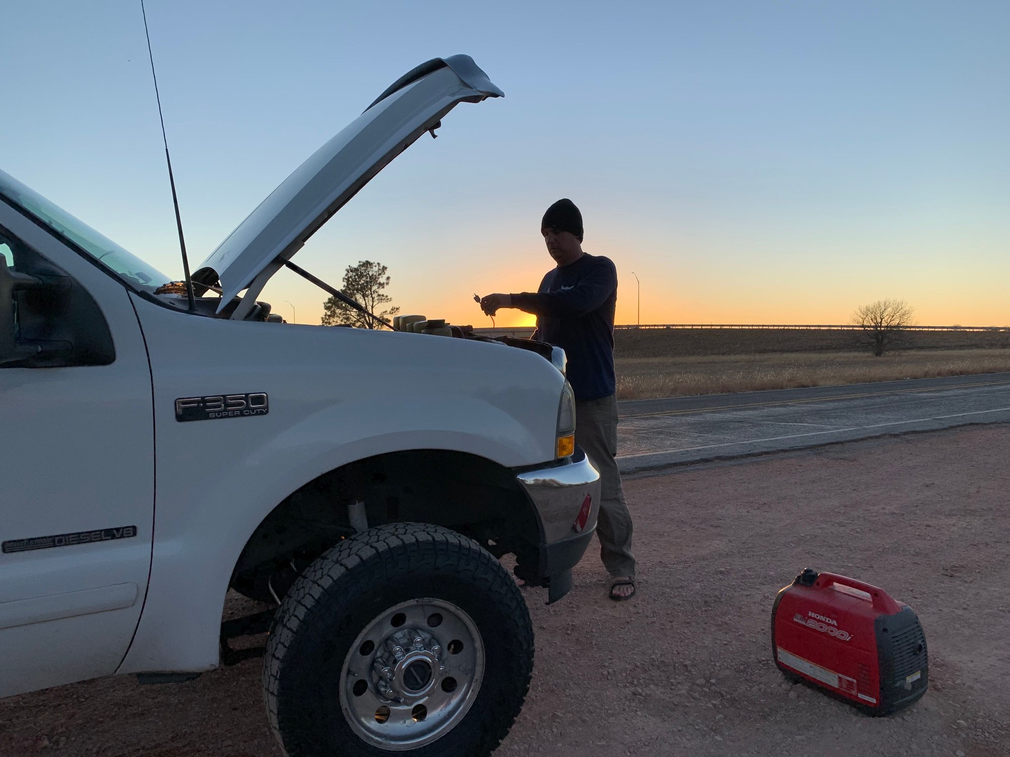

battery light illuminated in sayre, OK and we limped it to Doug Grey dealership where we got a helpful jumper tool from the awesome service guys there.. thanks daniel!
back on I40 the battery light quickly appeared and we died one more time just outside shamrock.. got it limped to shamrock - then had it flatbed towed to Gene Messer dealership here in Amarillo (thanks to Brian at Irish Road Service in Shamrock!)

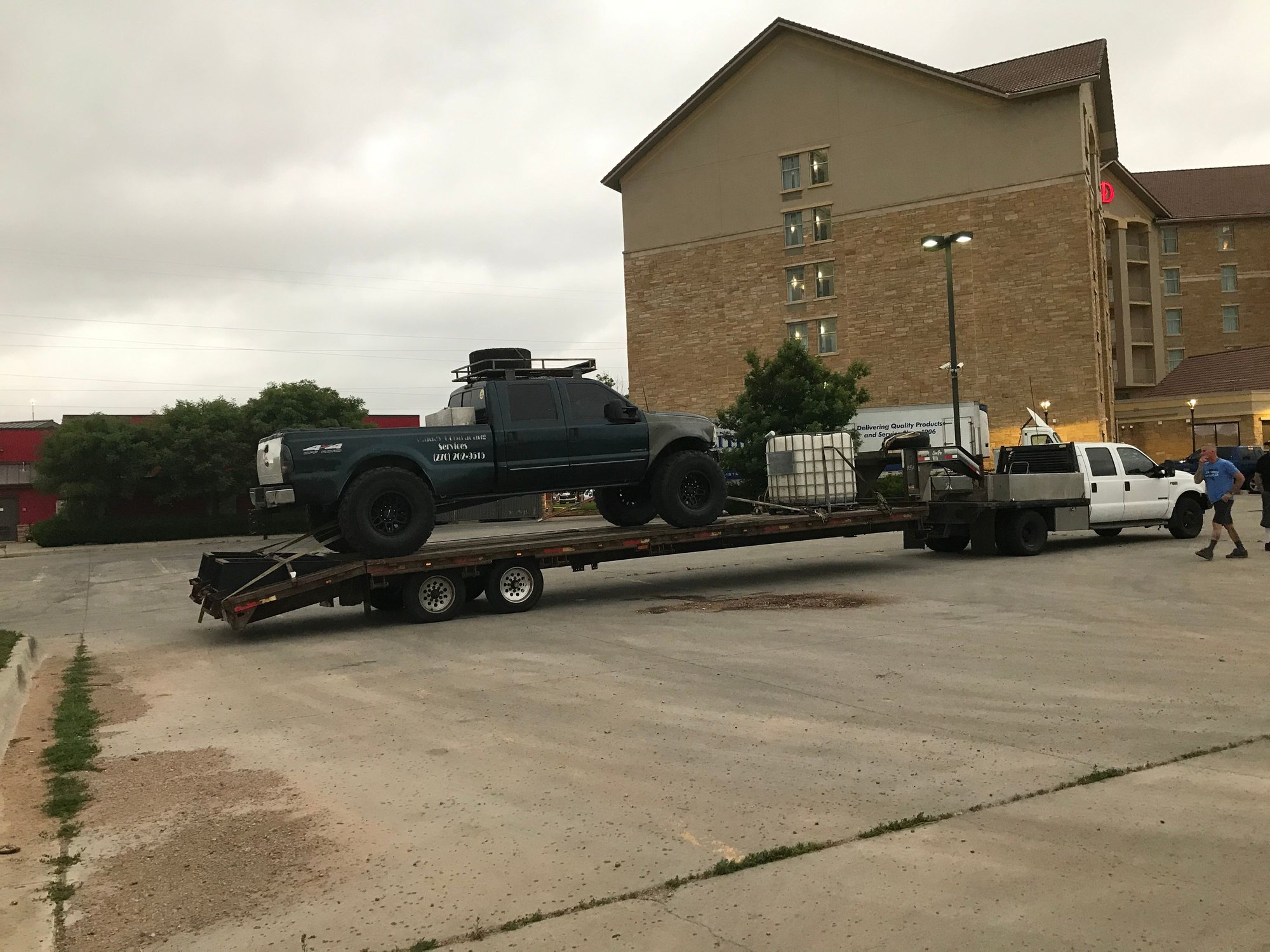

tow from Shamrock to Amarillo (thanks, Brian!!)
batts died w/ Sayre dealership temp fix.. glad the generator limped us along into Shamrock..
