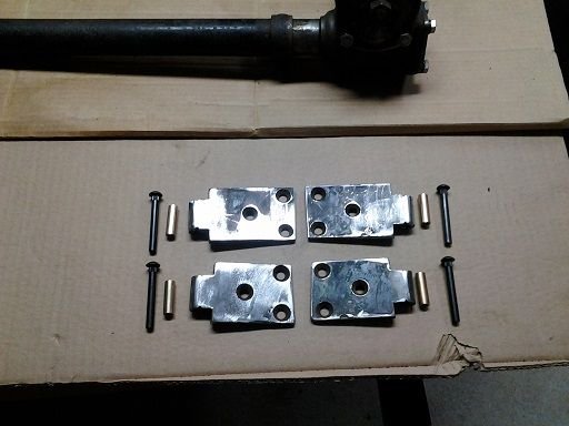

Removing door hinge pin to install mirror mount on to hinge.
So before I beat the life out of it, lubricate with too many profanities, I am seeking suggestions/tricks for removal of the existing door hinge pin.

I ended up removing the doors and drilling out the hinges and installing new oversized pins...... definitely not an easy job, I tried lube, beating the crap out of them, heat, nothing worked so drilling was my only option. Good luck and don't be concerned with the profanities..... part of life working on these old trucks!

I had to drill 3 out 4 of mine. One actually came out with lube, heat and beating it. Bent to punches getting them out also. Good luck!

I had good luck welding a 1/4 bolt head to one of my pins and pulling it using a short pipe and some washers that fit over the bolt head and pin.
I had to drill the other one from the bottom after soaking with penetrating oil for days. Finally got it out by driving a 1/8 punch into the 5/32 hole I drilled. It came out and looked like an inchworm.

There is a tool for that. Its like a C-clamp that simply loops over the door pin head and you pick out the correct spacer and twist its buttom bolt to slowly push the pin out. I am not saying it works 100%. Take it slow. But it worked great on mine. For under $50 it was worth it to me anyways.

all 4 of mine came out with a air hammer.

I thought this tool worked pretty good, but if the bottom of your pin gets mushroomed due to trying to remove it with a hammer and a punch, then it probably won't as you won't be able to push the pin up past the point of the pin bottom.

hinge in the vice
hammer and pin punch on the pin...once passed the knurl drove out easily
redrill hinge for oversized pins
drive the new pins in with lube
do the next one
did 4 hinges in about 2 hours and I wasn't rushing
