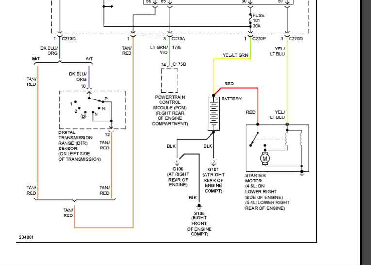

Is the start relay picking up? The pcm supplies a ground to start relay if its happy with pats security system . It also pulses ground to injectors and plugs , they have 12vdc standing on them in run and start check that ..
Sounds like you are bypassing start relay to starter solenoid . You must have a working pcm with signals from crank sensor to hit plugs and injectors at the proper time .
You need to check all fuses ,the pcm has more than one feed , injectors have one ,plugs has one .It seems to me your pats is not satisfied , what is security light doing when you try to crank . The pats system is not bypassable .You must have a good pats key .

Old Dec 17, 2021 | 04:15 PM

Today I had a little time to mess with it again. I provided ground to pin 85 on the starter relay and it will crank with the key but not start. I don't think my truck has pats, the key I've used for several years is a regular key I had as a backup. Lost the original long ago. At this point without a scanner handy, I'm leaning towards the pcm. At least it's turning over with the key now.Can the dealership look up by Vin to verify there is no pats?gonna call in the am.Want to make sure previous owner didn't try and bypass. any thoughts would be more than welcome! Thanks in advance

What do you think that flashing light is on your dash ? Its the pats security light ! Of course it has pats . Some one may have taped a pats key near the key transducer inside the column as a pats delete.
You can send your pcm off to a repair online and ask them to delete the pats program . But otherwise you can't delete or bypass pats yourself . It will not send a pulse to injectors or plugs unless pats is satisfied . Cranking is just one block feature . The pcm decides the timing and signal to the plugs /injectors .No way to fake that .
A pcm repair/delete is your cheapest way out of this . If you don't have legal owner ship it could get you in a lot of trouble .. After this fix a regular key will work . . It will be easy to steal . Paper trail will lead to you if not legal . . Involving dealer ship will be more costly .
