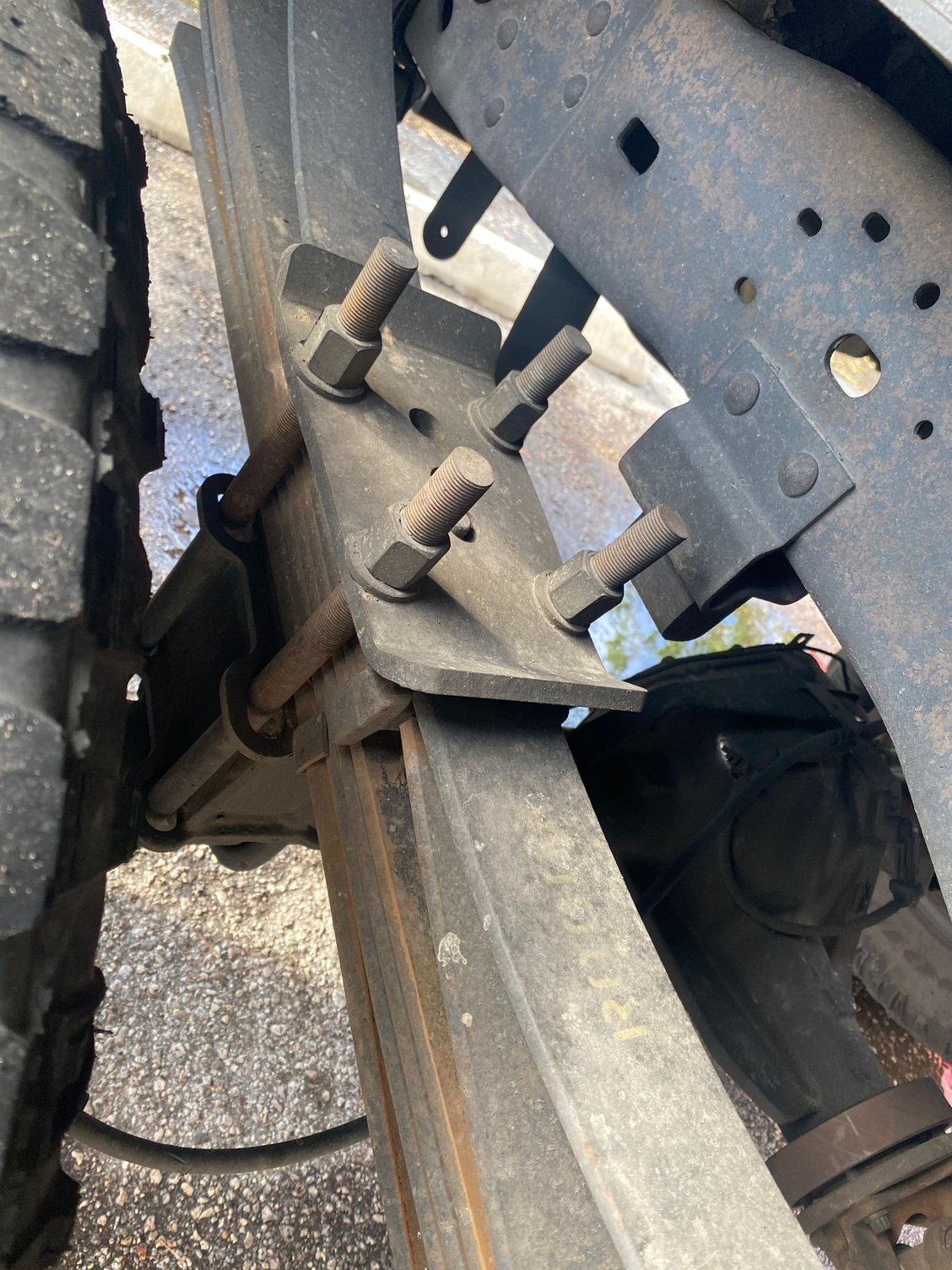

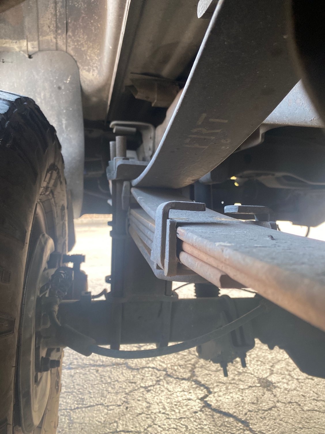

I went to put air in my tire and found the main leaf cracked. I know it’s a minimal difference but I’m trying to upgrade to the F350 springs. I called the dealership they said they have the B code rear that can be ordered. Unfortunately the dealer nor me know what that translates to as far a weight spec. Any guidance would be appreciated.

Can you zoom out a bit, to show the full leaf spring set up from eyelet to eyelet, even if in sections due to the tire & fender being in the way?
There are some peculiarites in that spring stack that do not appear to be OEM. Do you have a lift kit installed?

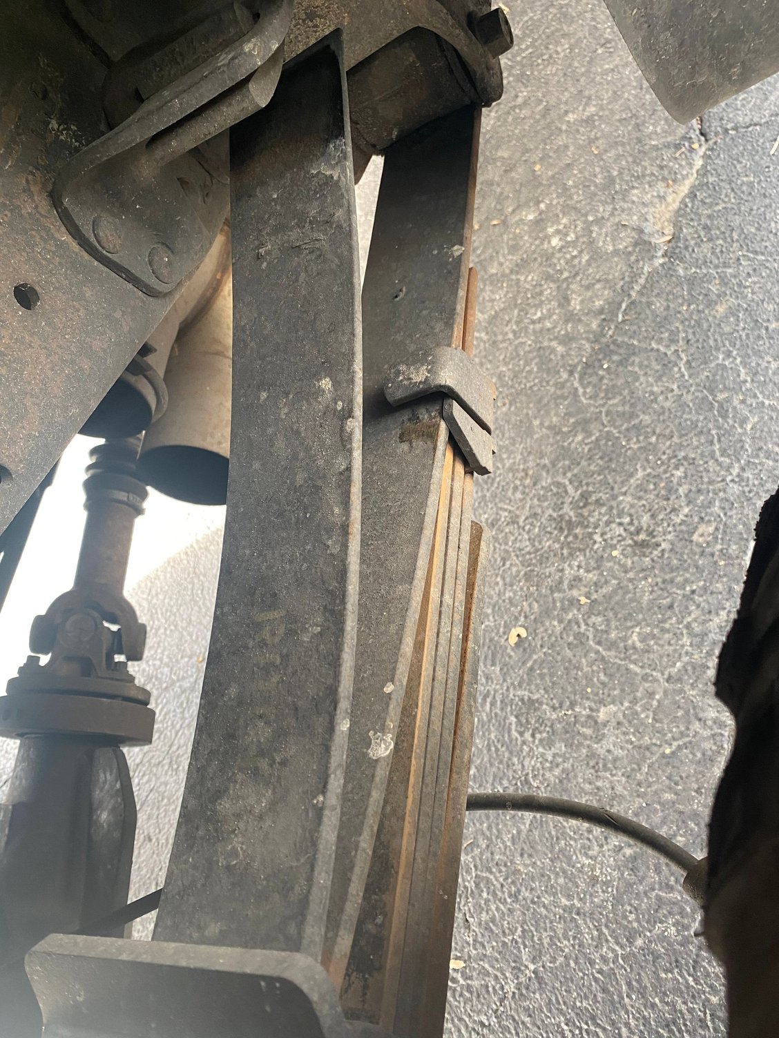

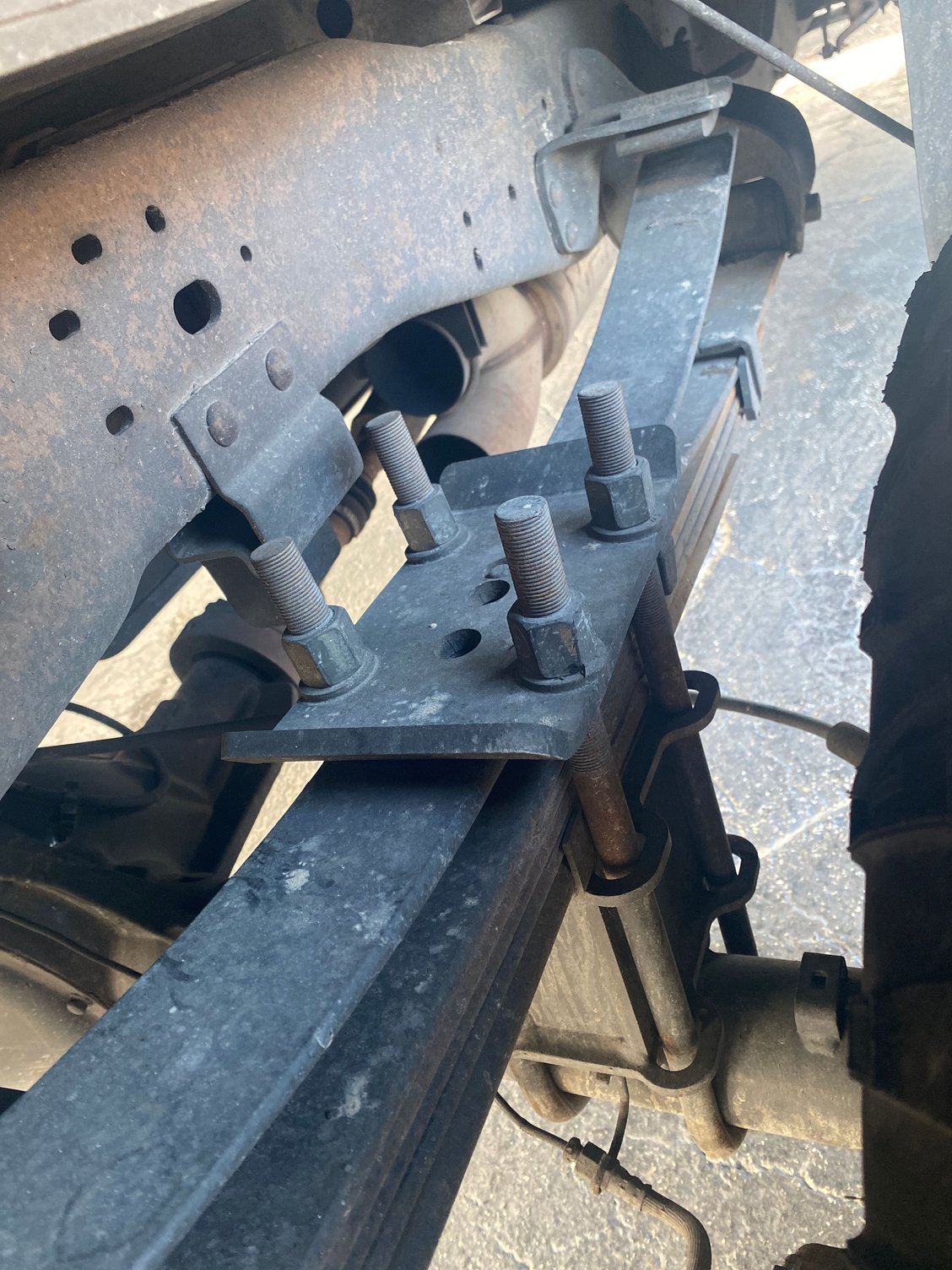

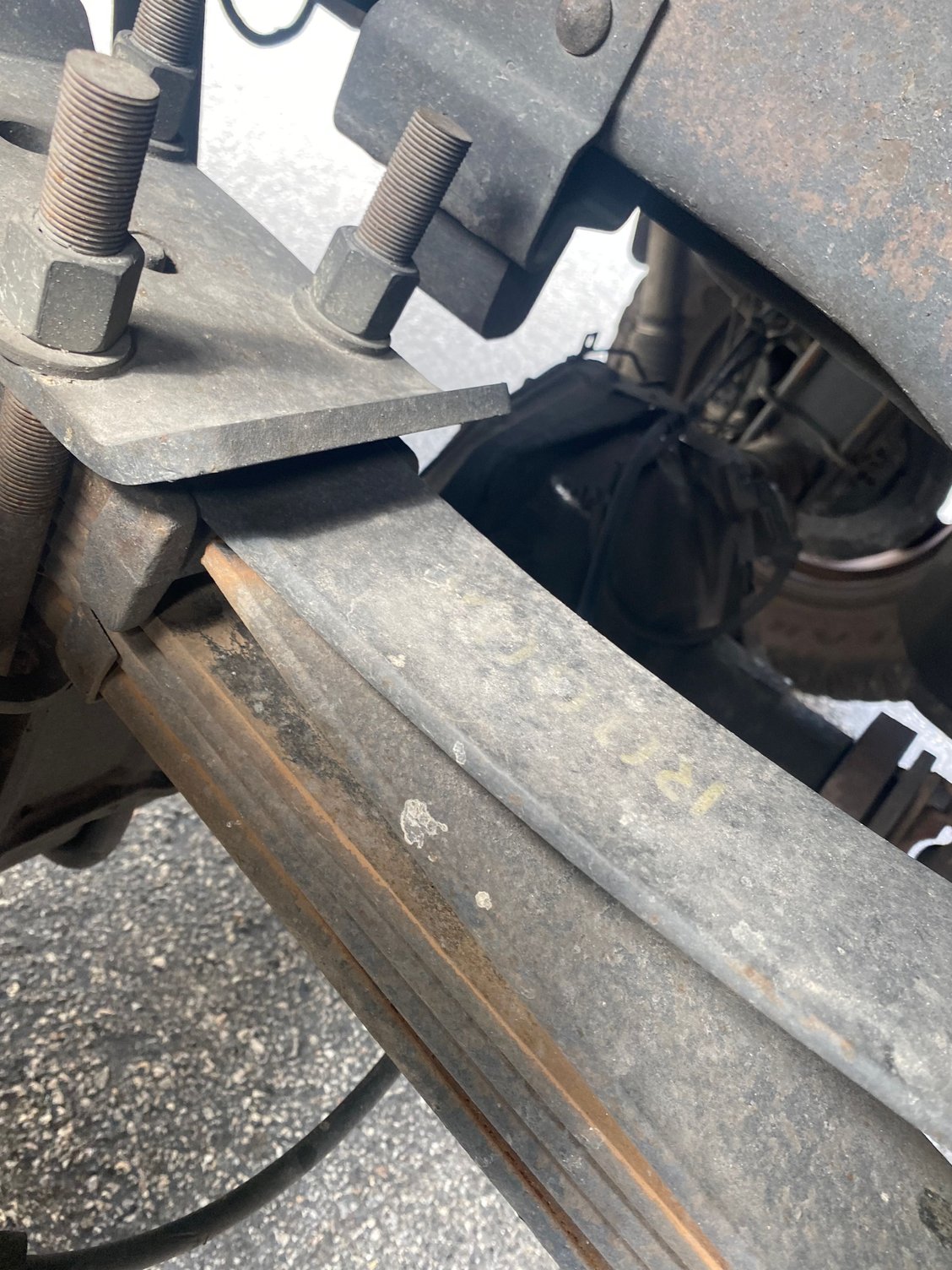

Here are some more photos I have the PmF blocks, 1 year new Ford helper springs (thankfully replaced those or my truck would be on the floor now) and 3/4 u bolts. Unfortunately there is no time for me to place an order from the suggested sites I’m currently 90 miles from HQ repairing another vehicle then calling a flatbed to bring me home.

Thank you for the additional photos. They really helped in making the situation you described more understandable.
