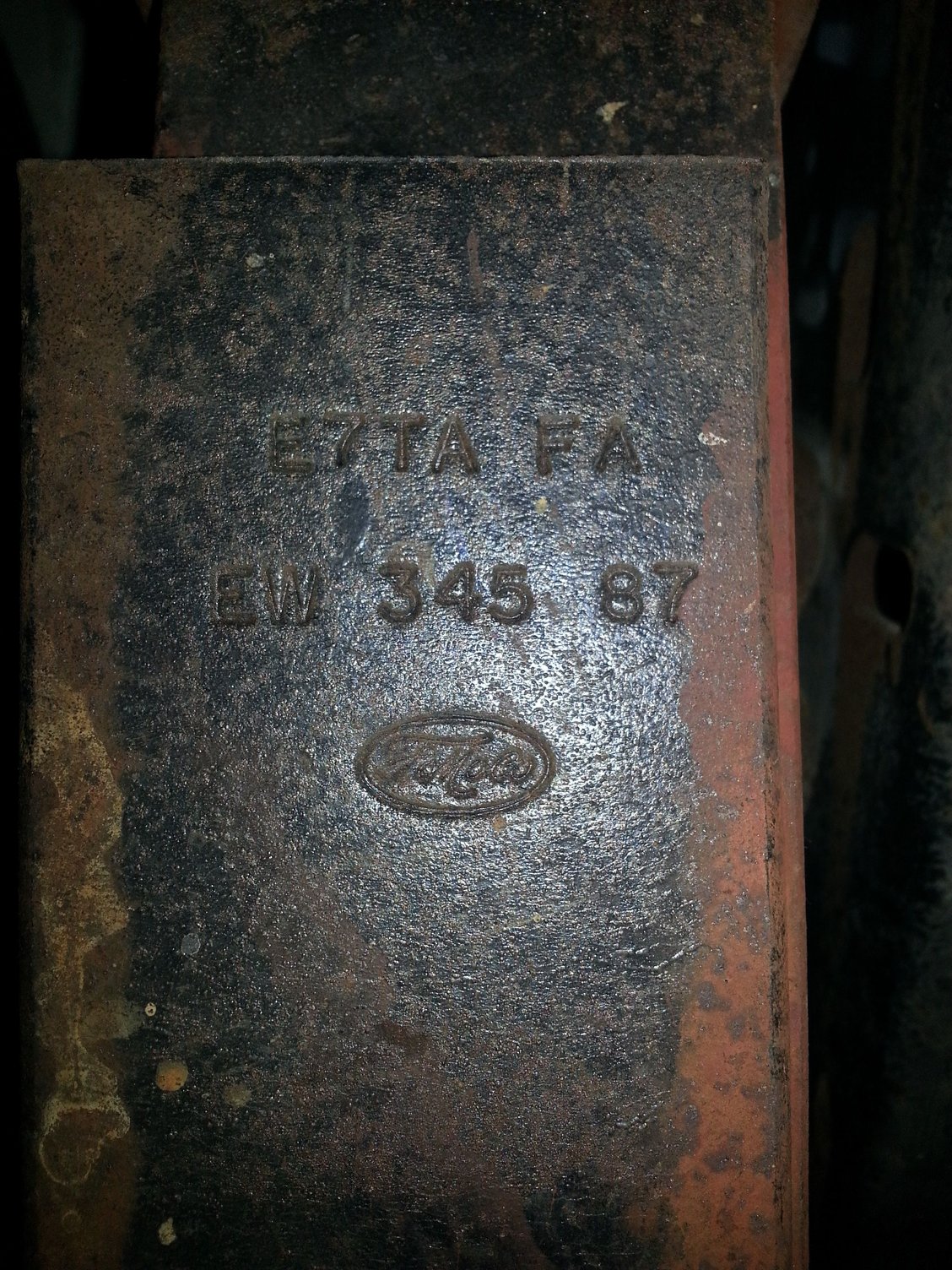

This is what is stamped on the leafs. Dont know if that matters?
Thanks for the help!

If you look at your spring pack, you can see someone added an add-a-leaf(2nd leaf from top in the main pack)
Also No f350 ever came with only 4 leafs, they were all a minimum of 5(not sure where you found that 4 leaf info, but it is wrong)

I can tell the second leaf form the top is not stock because it is a different color than the rest
Also the overload leaf onto of the pack may not be stock either. The pads on the frame that the overload spring rests against. Are they riveted on or bolted on?

also see the one that Brad noticed was a different color? the second one down in the main leaf? not only is that one a different shade,but look close it's a different thickness.
that's exactly what i did lol! i had a late model f450 ('99+) spring pack laying around so i used one of those.you can tell they are a bit thicker.my guess is,this guy had the same leaf on hand,and or replaced it with a extra hd spring for good measure on purpose.
