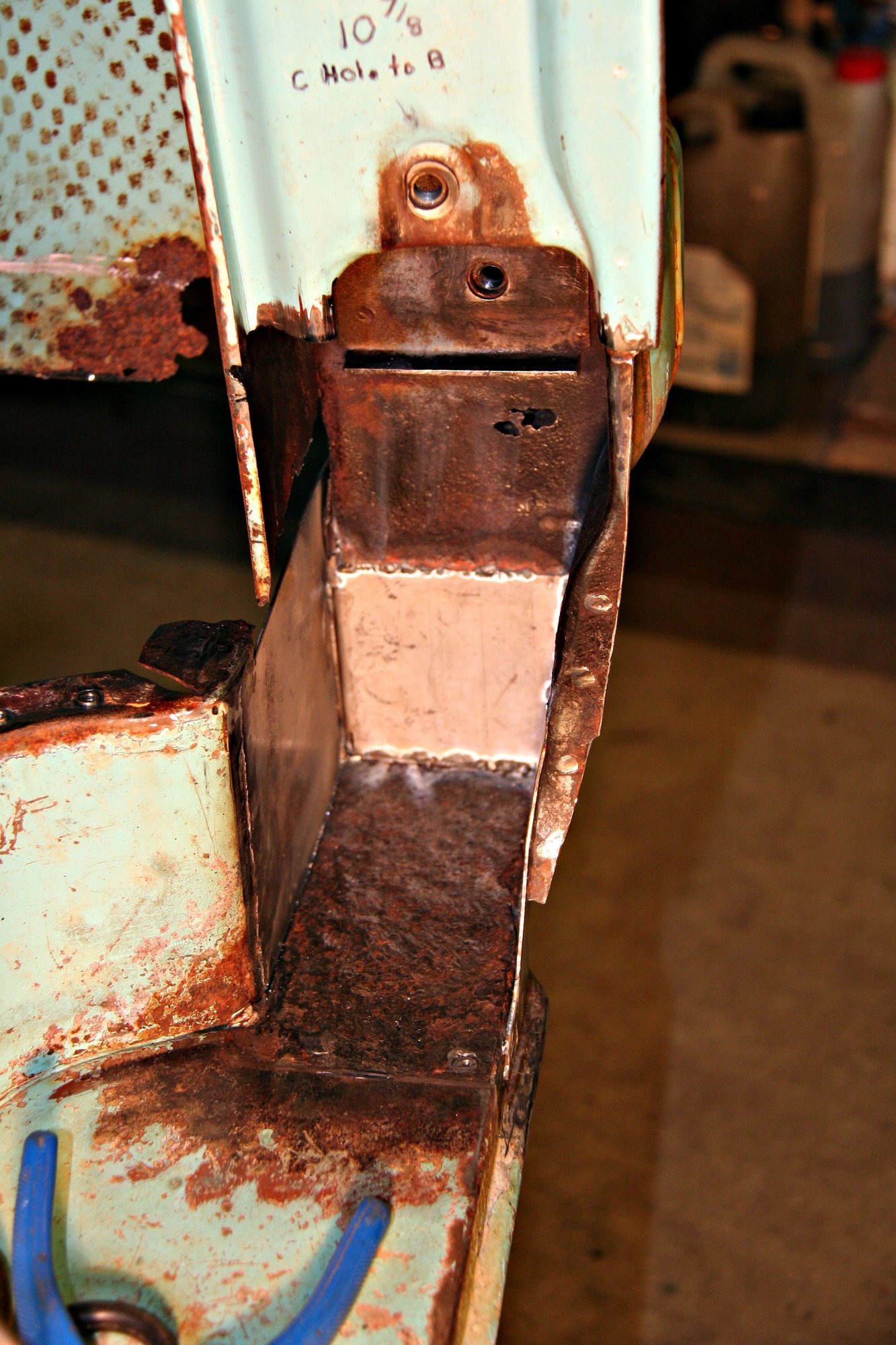

Is it repairable
As others have stated it is a lot of work. I am working on a 63 that was actually my first vehicle. I live in Alberta, Canada so reproduction pieces cost a lot of money. Between the exchange, shipping charges and customs it is double the list price before I have it in my hands, Then there is damage done in shipping. I had to rebuild the same items you are looking at.
Front cab corner in behind lower door pillar
Lower front cab structure boxed in with nre metal.
RH side may be able to see where I split it on the lower left
