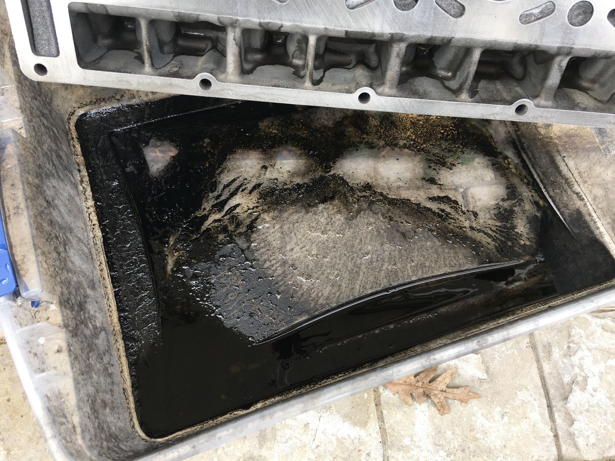

I just wanted to show with the video what damage an EGR cooler can cause. Important in my eyes is also that the engine does not suck exhaust gases and gets only clean air. A CCV reroute serves only to ensure that the intake system is not oily. The oil "mist" has in principle no negative influence in the engine.

gotcha, I see, so the oil from the ccv mixed with the exhaust is what causes our intakes to get caked so badly. The oil doesn't cause an issue, it's when the solids mix with it and then get baked. I remember it being thick with black crud but I didn't think about the ccv.
Man your pictures, you should collect them all up and publish them (maybe get Jack to help), they are so helpful, it really puts it in perspective regarding the "quick fix". I will definitely pull the intake now. Thanks

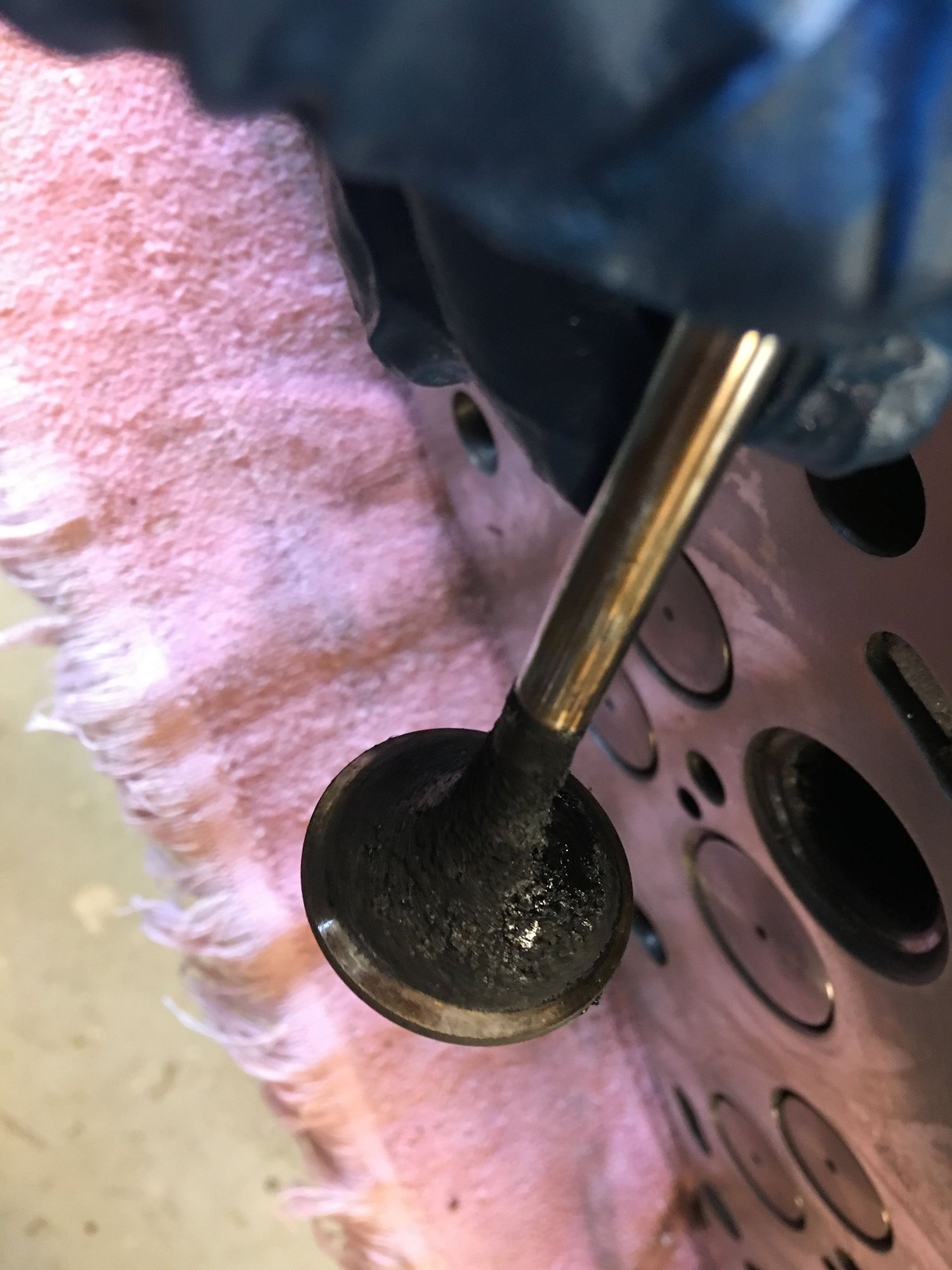

Old Nov 17, 2021 | 11:43 PM
Pyro-Z's Avatar
Pyro-Z
Joined: Nov 2021
Posts: 12
He may have to go to 0.020" or 0.030".
Oil plus carbon from exhaust is a really bad idea.
dang, an intake valve. Bet the exhaust valves look a lot better. Every Gadget Ruined

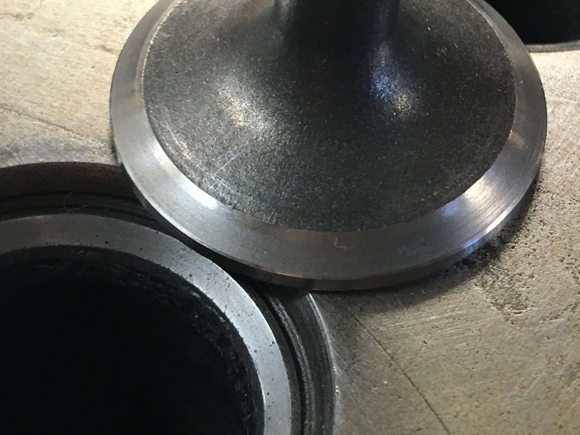

They are stainless, softer, so highly pitted. I need to change the exhaust valves and ended up replacing them all.
