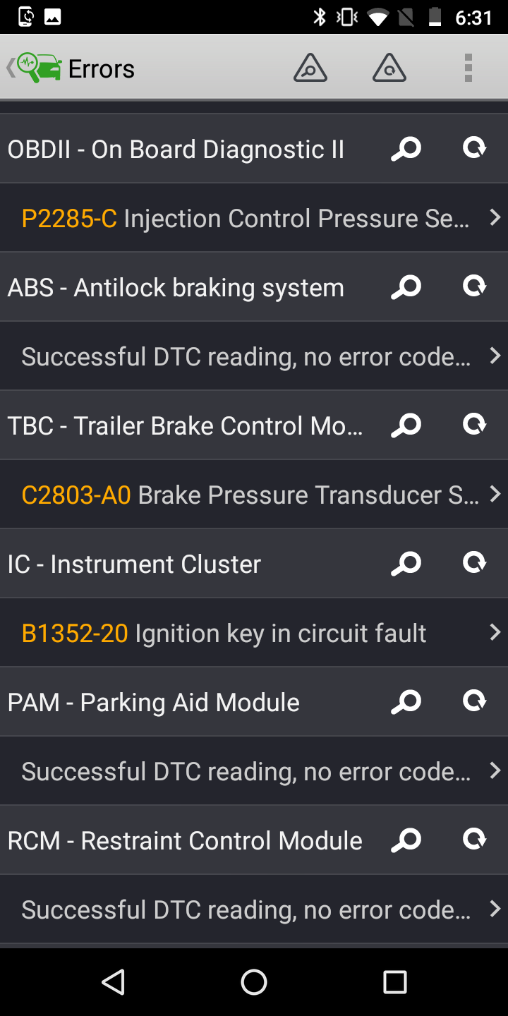

Old Oct 3, 2021 | 05:34 PM
rhughes123's Avatar
rhughes123
Joined: Sep 2021
Posts: 56
welp looks pretty rough
