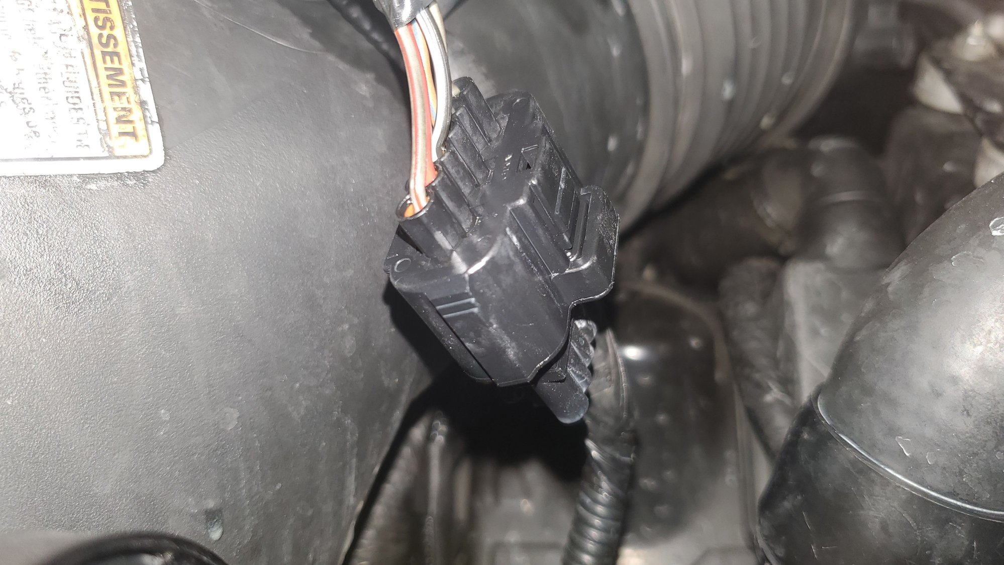

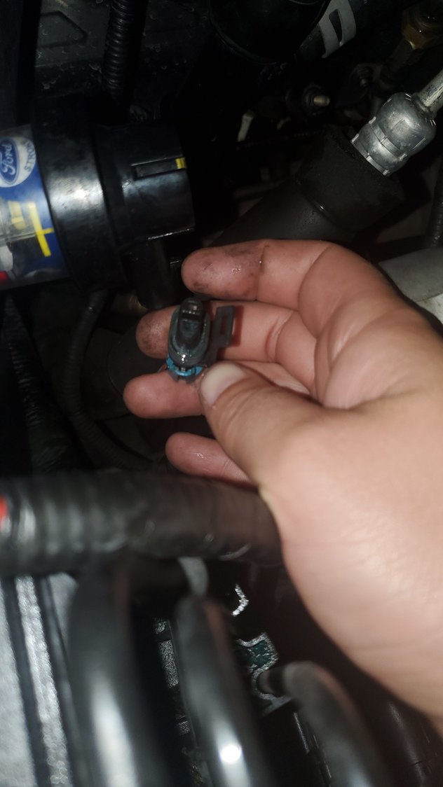

i will say underneath my coolant deegas bottle there does seem to be what looks like "wetness" that is on some of the wires. like they have been. also three wires by the same are are just randomly cut. two of them go up to the light on the inside hood. but that light doesnt work

those are what im referring to

Those three wires are factory and I believe they are called customer access wiring...they play no role in anything.

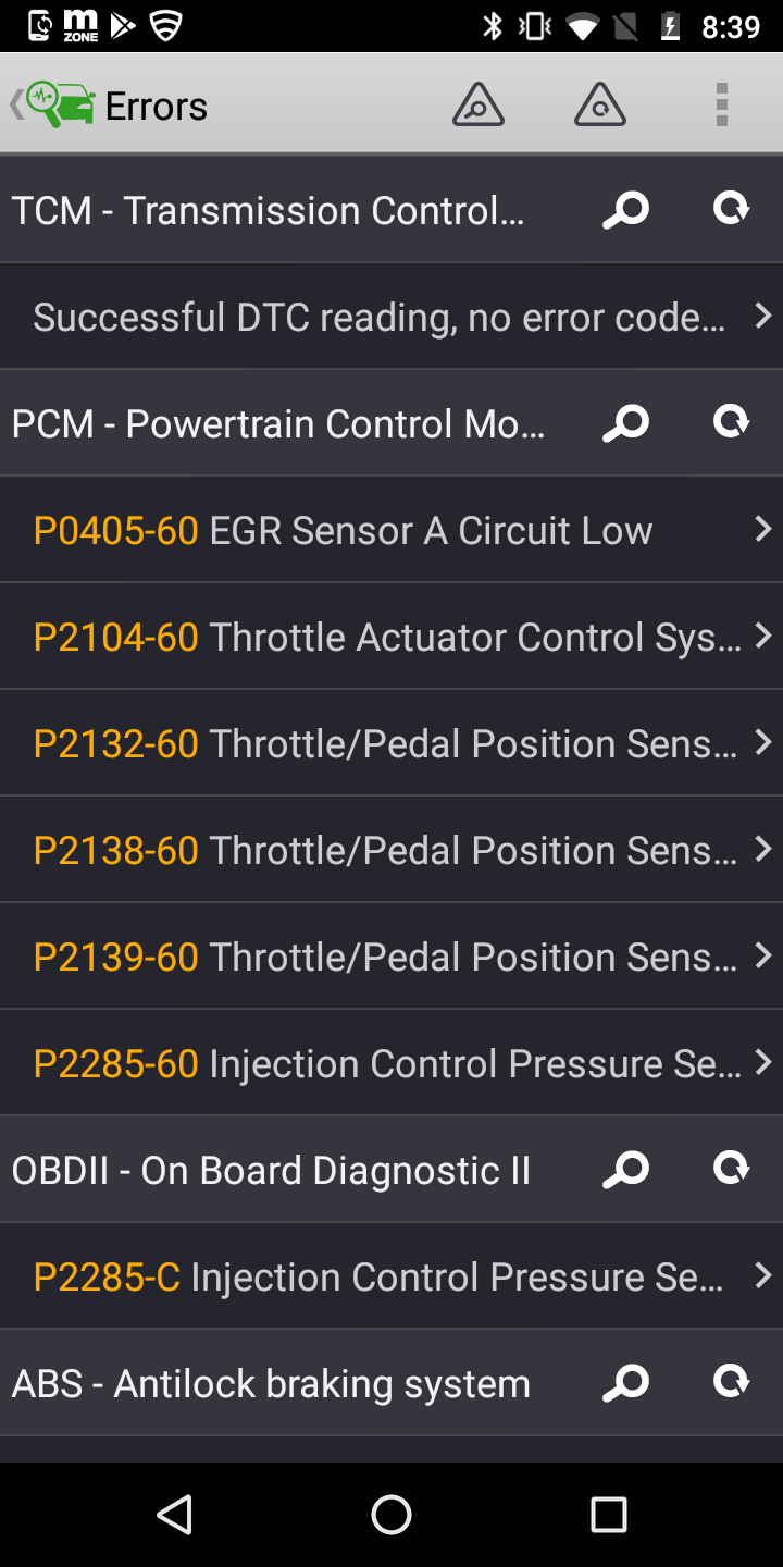

do u think based on the codes i have a bad pedal sensor

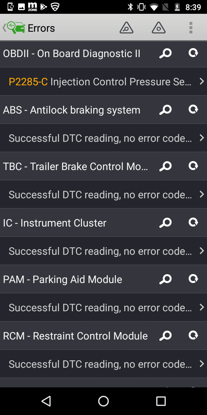

i just reset codes to see what came back this is what i got

The accelerator likely is not the issue. Check the Vref voltage and it should be at or very near 5.0VDC
A short in the EBP plug can cause this very issue. We had a guy that must of thrown $2000 at this very
issue and never fixed it until he checked what we had been telling him to check all along.
So check the Vref voltage and watch it and wiggle wires. If you see it change while wiggling you have
a place to start looking.
