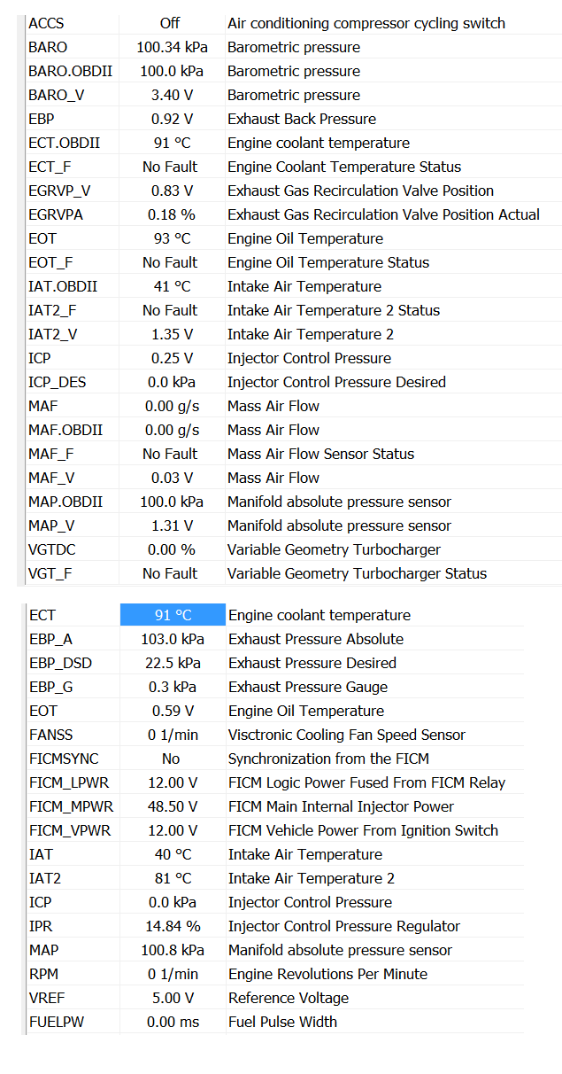

All in all, it felt normal - maybe I've never had boost, lol. Here are the data pics. Sorry, can't figure out how to display in Farenheit, and I just threw in every PID that looked relevant.
KOEO
idling after start up
Idling after driving WOT

Since you say it drives normally now, maybe more test is needed to confirm that.
Other than that, athought I am a bit struggling with metric unit, a few data points I looked at appears fine. If you want to test turbo, the truck needs to be running at least 35 mph, and add some acceleration. I know it's hard to capture that, but idle only produces 1 psi in my opinion.

To me, what I see is that the EBP desired is 35, the actual EBP is 8, and the VGT % duty cycle is 85%.
Sounds like a turbo or VGT actuator problem.
Thanks, Mark. I wonder if that could be due to leakage out the exhaust manifold connections? Dang, I didn't swap the turbo, since the vanes seemed to move easily. I wonder if it's just the actuator or the pigtail. One side of the connector clip is broken, but it seems to stay in place. Dang, I should have swapped in the other turbo, but I don't know anything about it, and it's been sitting unboxed for two years.

I forgot about the leak. That certainly could be the reason for the low EBP and high VGT Duty Cycle.
