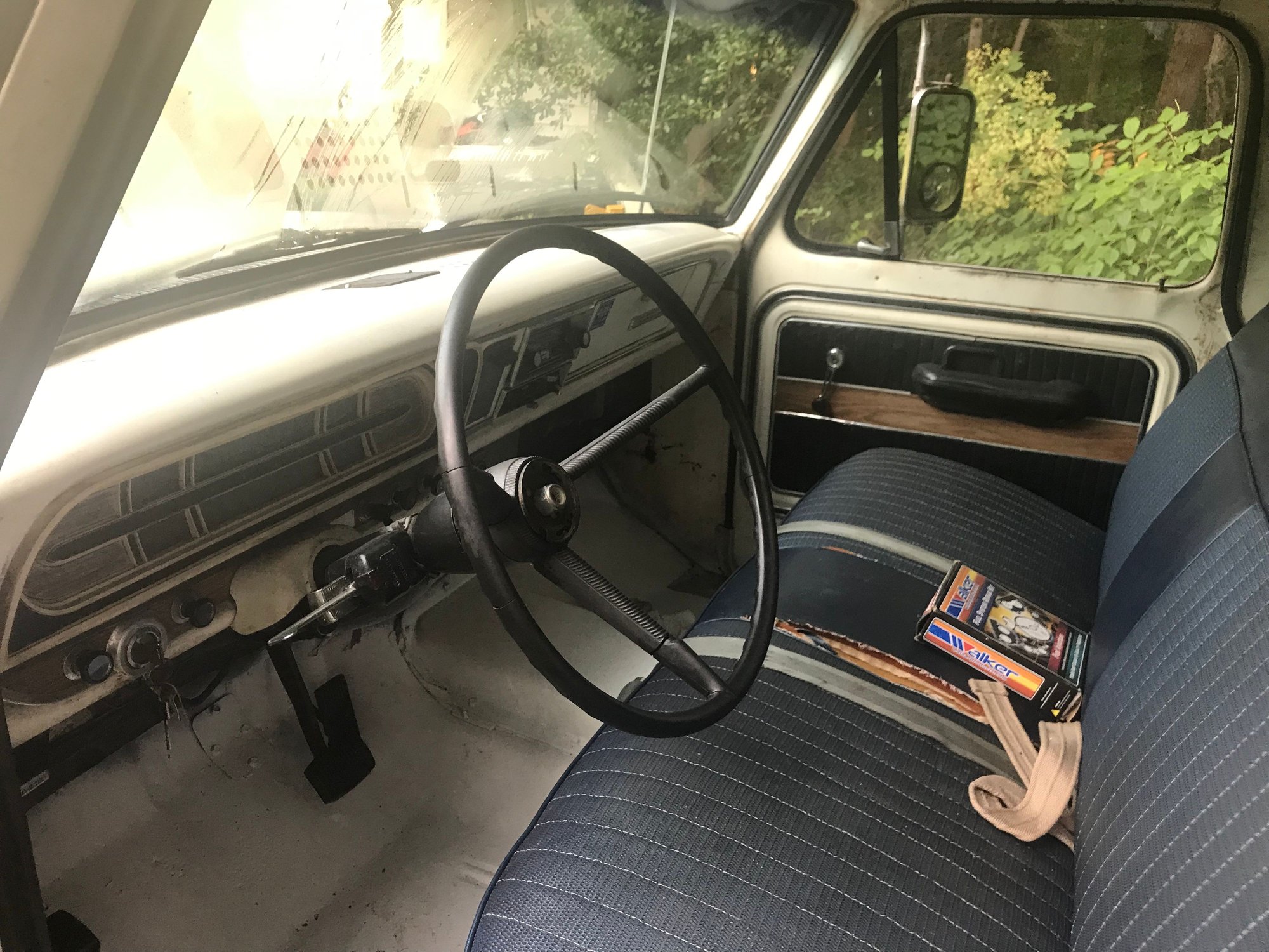

Picked up this truck a while back it’s a 1969 f100 ranger with a 360 and c6. Truck is bad shape, has been sitting for years with the bed full of trash. The bed floor is is in bad condition lots of holes. The cab is is solid with only a few small holes in floor by sill plate. Truck is solid on the underneath.

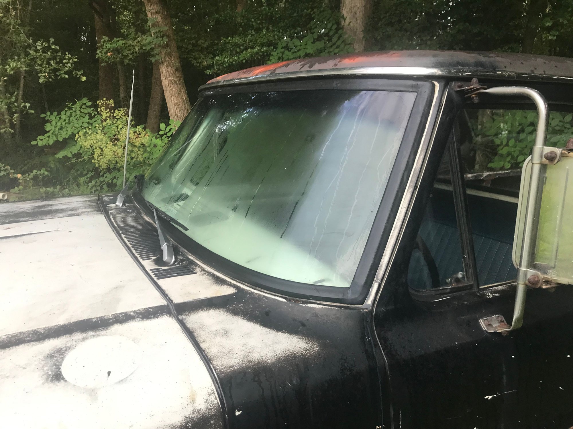

I rebuilt the carburetor and got it running, surprisingly everything but the blower motor works. Even the brakes work, I changed the oil and topped of all the fluids. Engine has two cylinders on the driver side that are not 100%. But the more I drive it the better it is running. Hopefully they will seal up if not motor will need to be gone through. I had a extra windshield gasket from my hoard. I replaced windshield and installed new gasket.

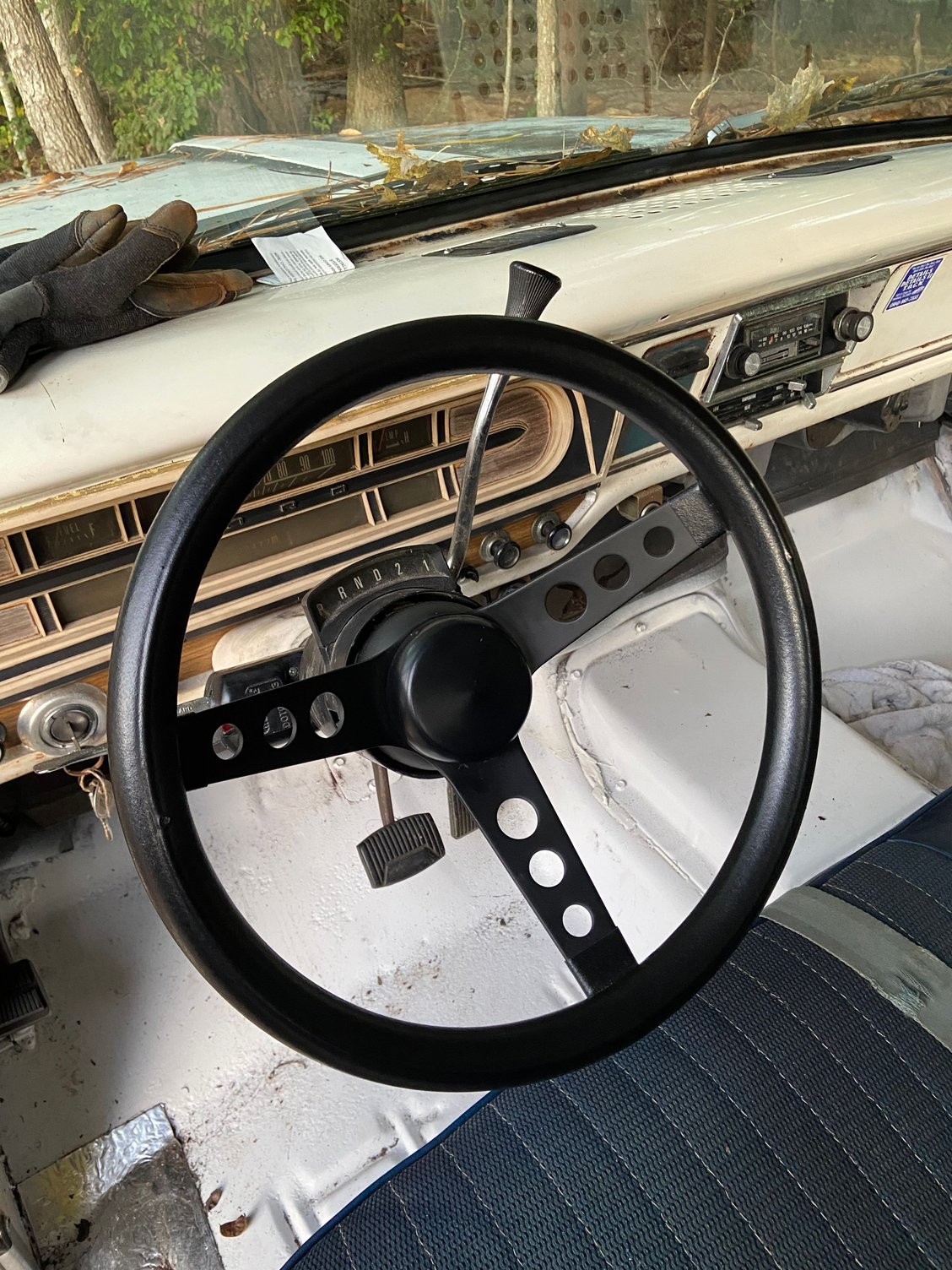

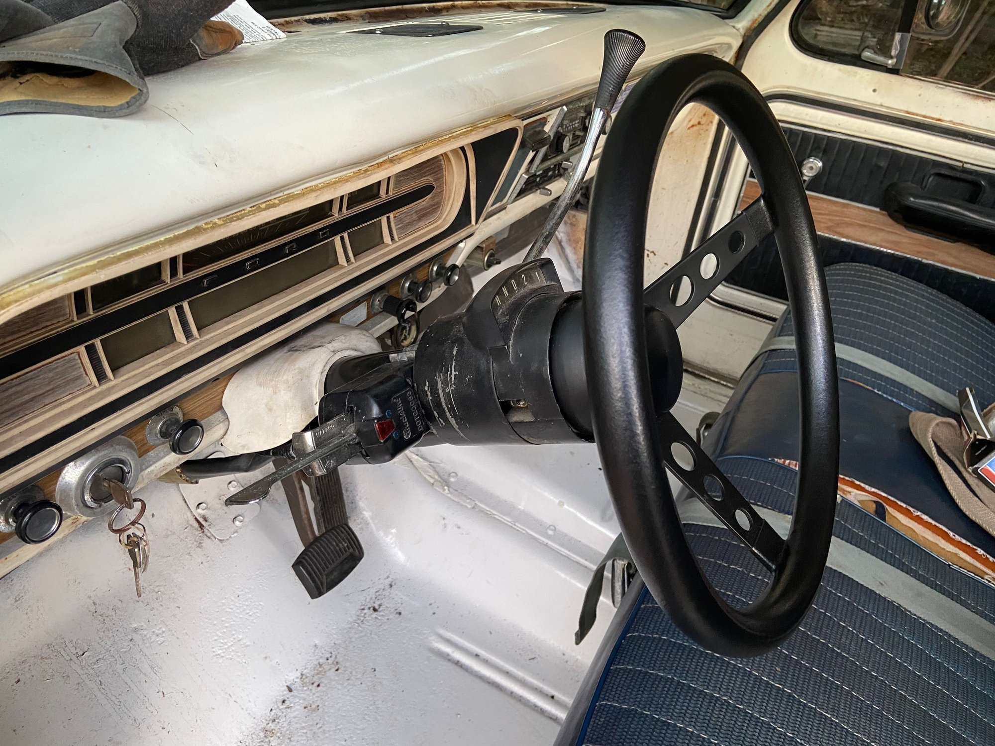

The po replaced the rag joint and destroyed the lower column bearing and column. The shifter was also broken out of column. I had a good auto column out of a 78 bronco. It bolted right in to factory mounts but is a few inches shorter going through firewall. I had to notch the fire wall column mount for clearance shifter. Also had to make a adapter to lengthen and connect steering box. Purchased a $50 grant steering wheel from Amazon. Installed it with the adapter that came with truck.

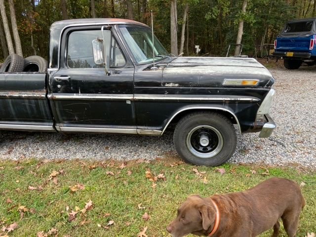

Painted the wheels black
