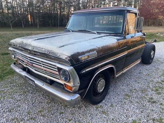

Finished the front bumper mounts and installed bumper.

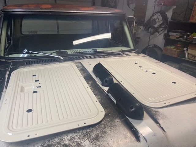

Replaced the door glass felts and the window track rubber. Lubed the window regulators and cleaned out the door bottoms. Removed two custom cab door panels from my parts truck and painted them. Purchased two new arm rest and carpet.

Installed door panels looks much better

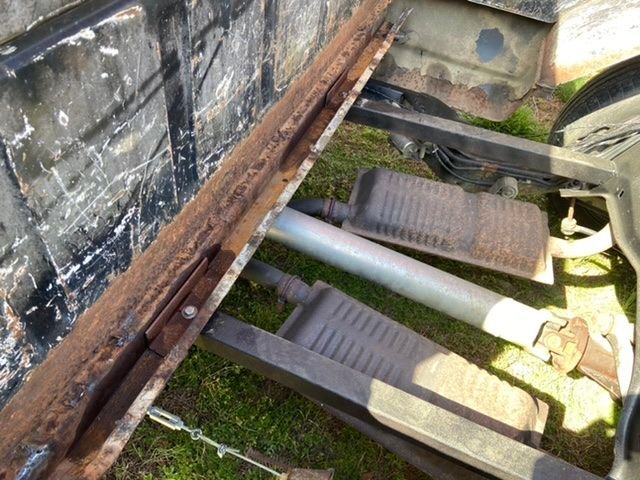

Bed cut down in front still need to do the rear.

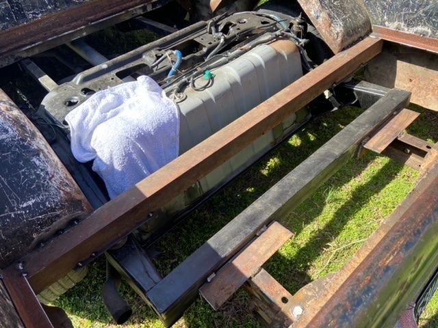

Used board with two screws through it to mark bed worked great, Cut 16 in out. Must have done it somewhat right bolts holes for bed crossmember line up perfectly.
