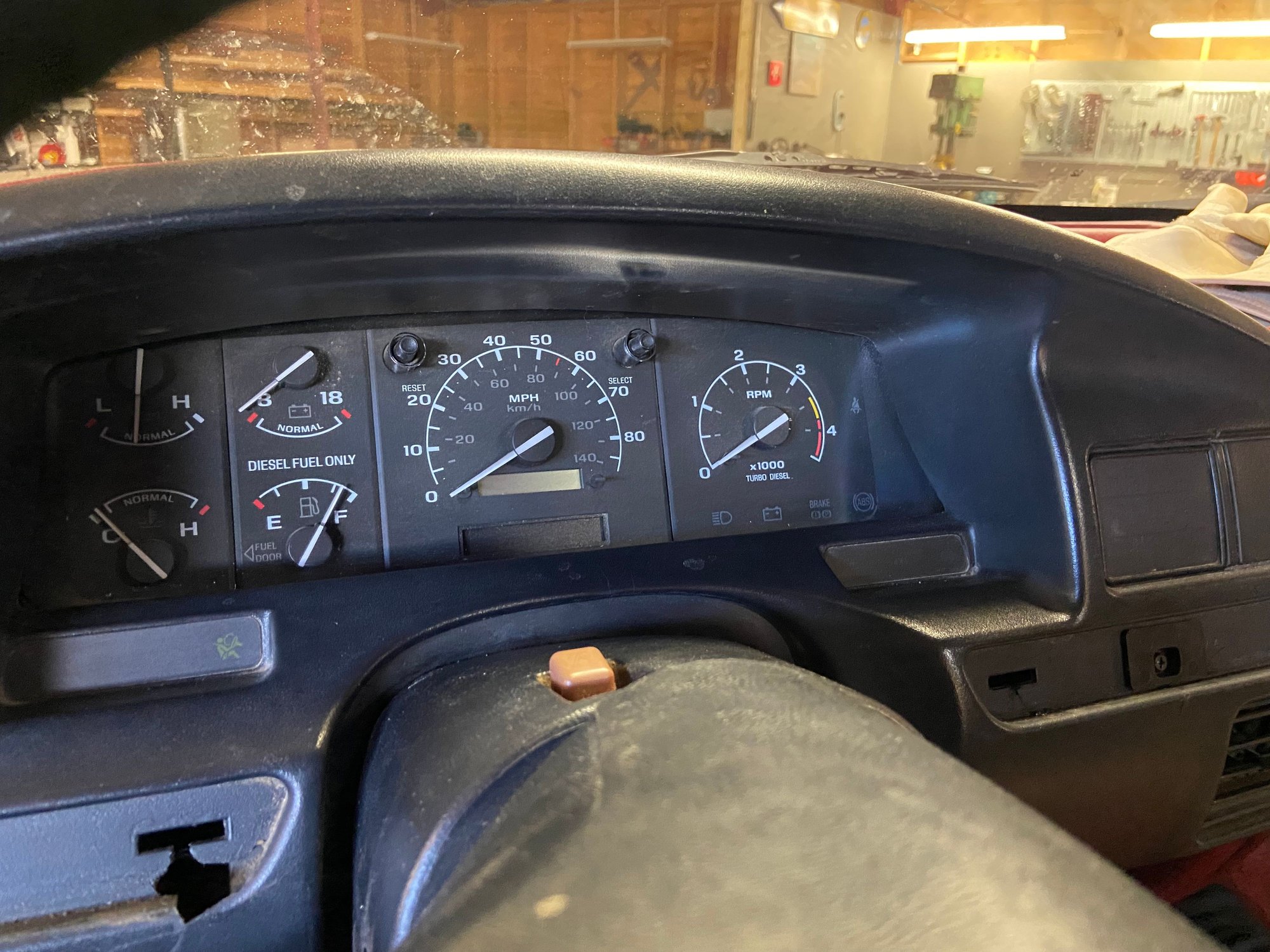

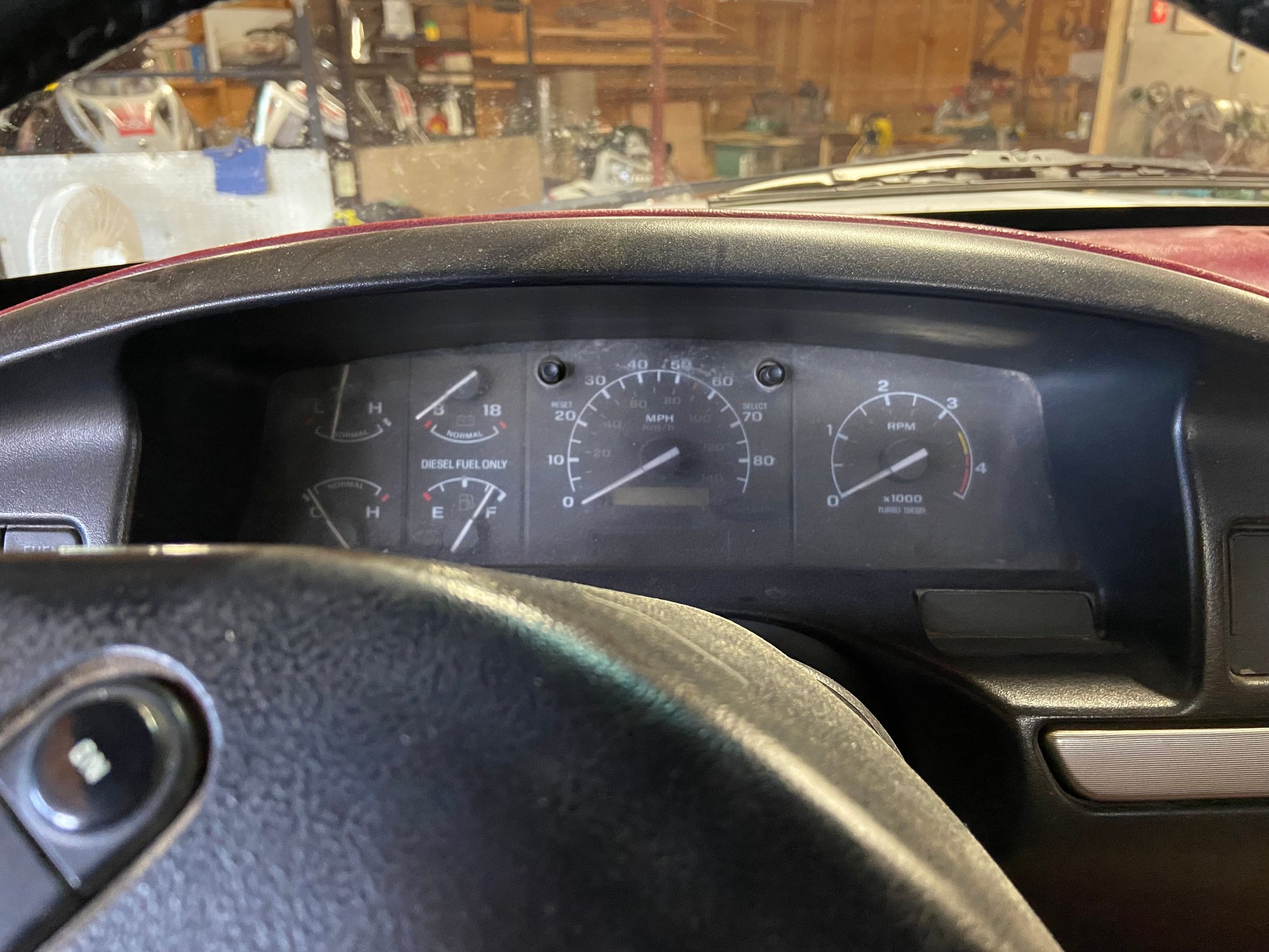

Put in new instrument lens. This was a farm truck so it was scratched beyond repair. Also replaced the “wait to start” module as it’s had a crack since I bought the truck. Used some of those plastic inserts from CP that go where the screws go for the cluster surround , they work great.

Where did you find that? And how hard was it to replace? Mine's had a crack since I got it and over the last 2 years it has just gotten worse. Been thinking about tearing it out to make the cluster red instead of green and orange as well so I might as well hit two birds with one stone.

eBay is filled with parts. It's fairly easy to get the cluster out. You may want to drop the steering column an inch or two for more clearance and plan on cracking the cluster bezel on removal. 30 year old brittle plastic doesn't like to be disturbed.
Cluster Glass
Cluster Bezel

eBay for the bezel. Complete Performance for plastic inserts that go where the screws mount the pod (an area that’s always cracked in my experience)
https://cpaddict.com/products/dash-b...erts-1992-1997. They sell the whole pod but for the price I’ll stick to gluing mine together as long as possible.
My wait to start had a crack in the lens too, found one on eBay.
It’s not a hard job. No need to drop the column, just tilt all the way down. Take your time as parts are brittle. Get some JB weld Plasticweld so you can fix cracked parts.

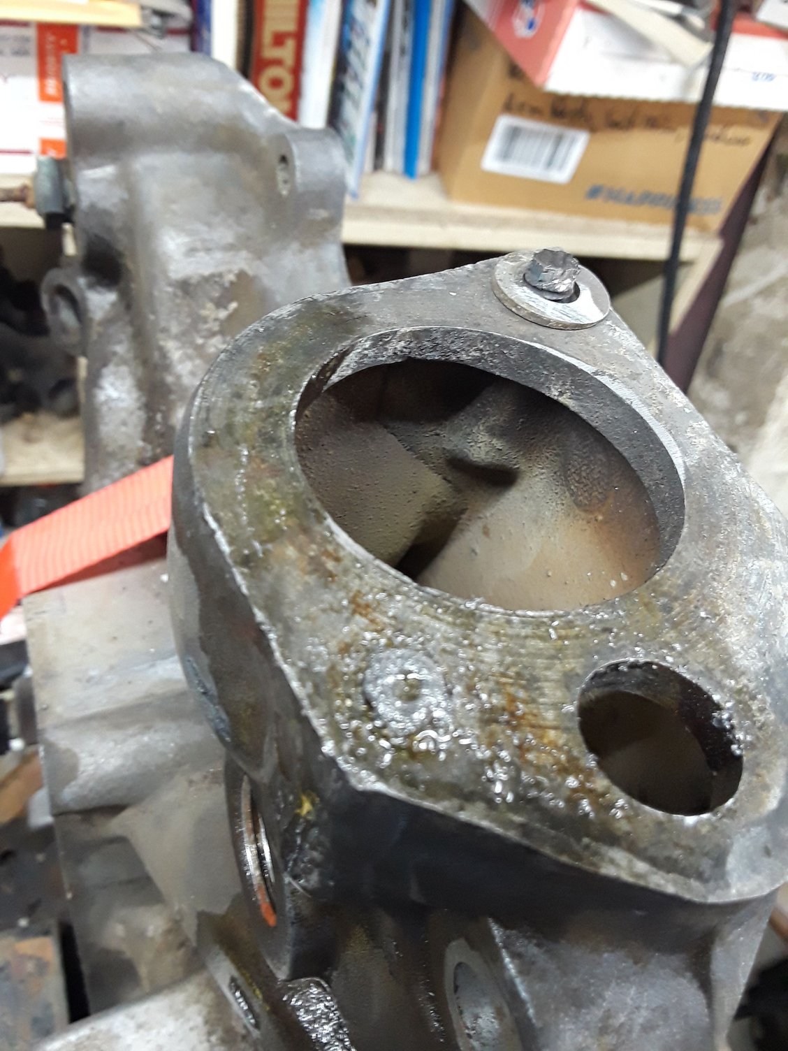

Drilling broken bolts
Attempted welding nuts on broken thermostat bolts with no luck, and didn't want to blow the aluminum intake apart. Now attempting to drill out the bolts. Going to try an easy-out tomorrow.

Have you soaked the bolts with Kroil ?

Currently PB Blaster. I might have to try Kroil, looks like Walmart has it.
