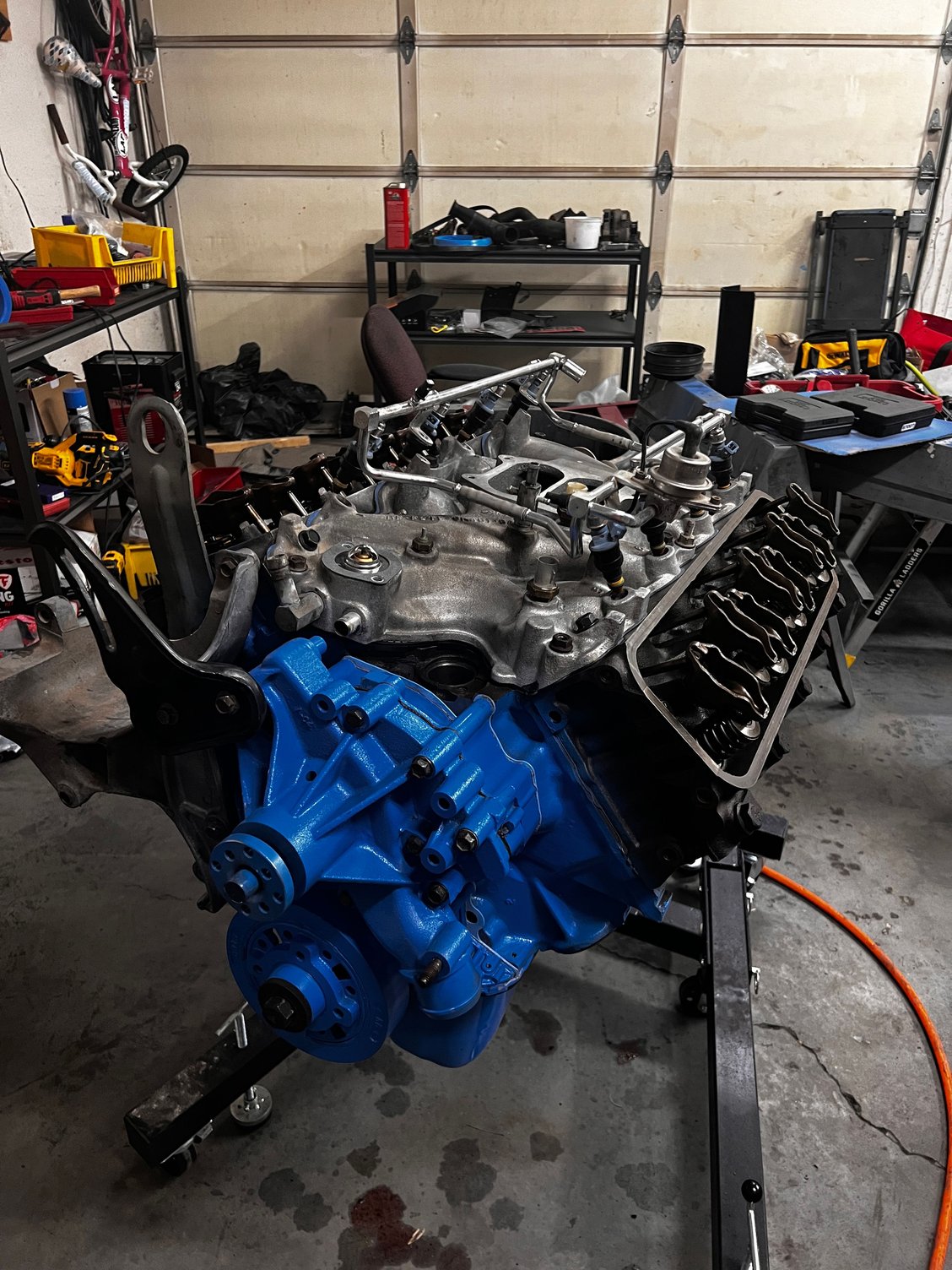

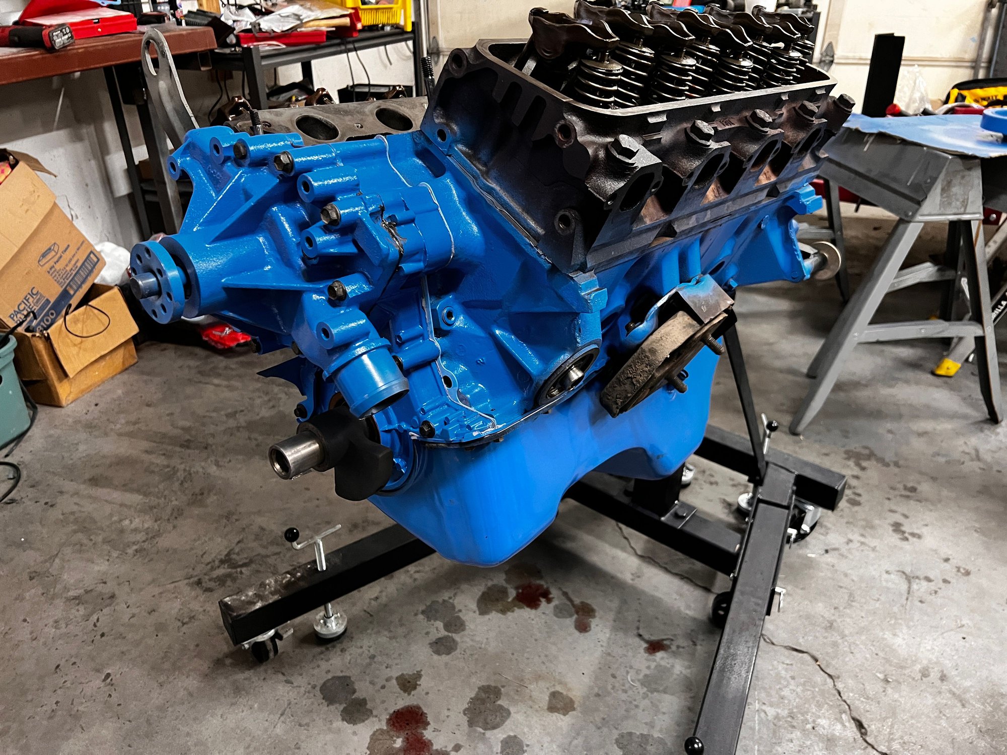

Engine change.
This is the engine going in.

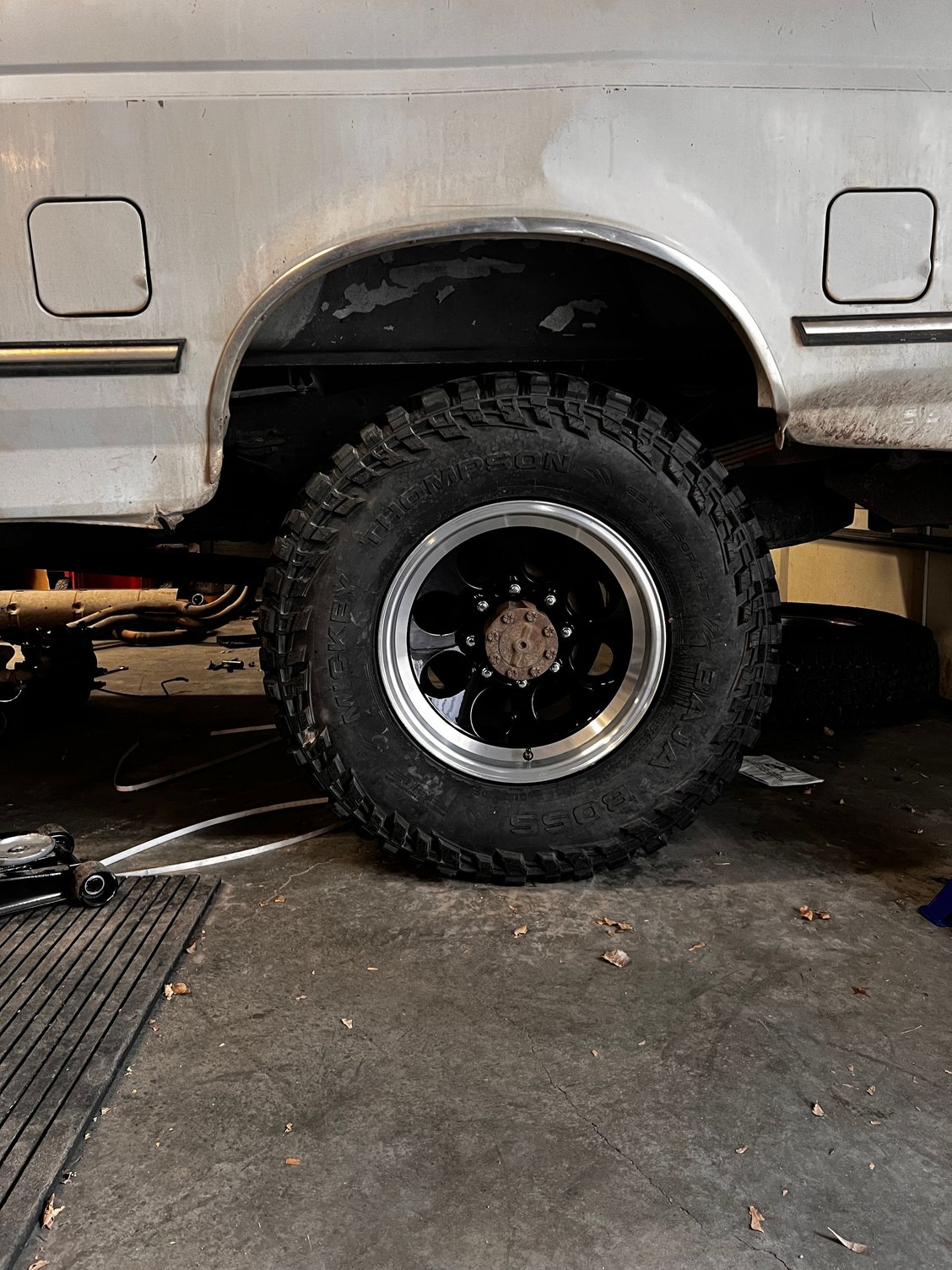

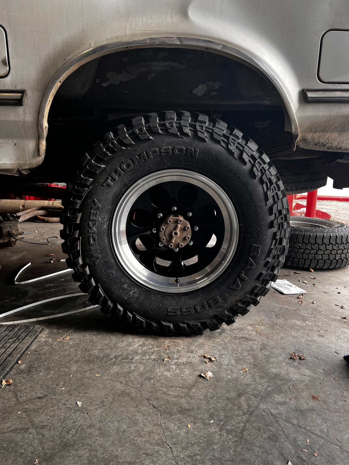

Mickey Thompson 35’s
Putting in Mickey Thompson Baja 35’s and Ultra wheels.

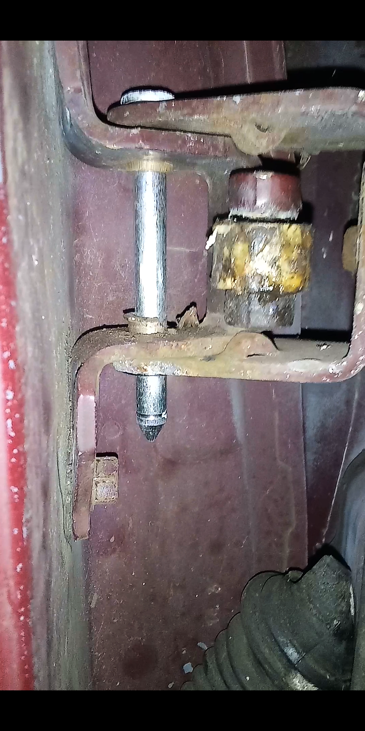

Discovered a broken bushing in my driver's side door hinge, because it wouldn't close right again.
I didn't replace the bottom bushings when I had the door off and I should have.
Next time I get a chance, I'll be redoing the job.
Edit: I did replace that bushing. It must have cracked on the way in. The top bushings looked ok, so I left them.
Replaced this broken bushing. I know the replacement wasn't cracked. Hopefully it holds.
If the original steel hole isn't perfectly round, the brass bushing will crack almost immediately.
