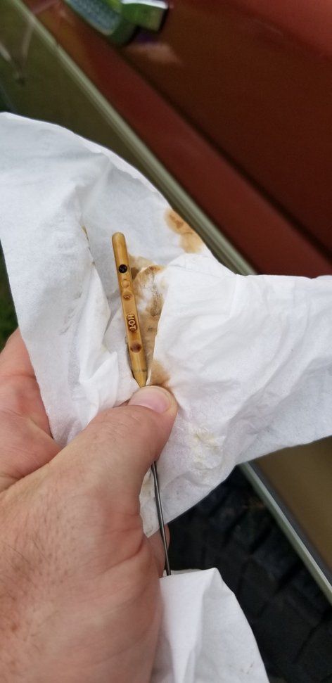

Old Aug 16, 2021 | 06:27 PM
jergar4's Avatar
jergar4
Joined: Apr 2018
Posts: 27
This is what it looks like. It seems to have plenty but when I wiped it, it was mostly brown with some black.
Old Aug 16, 2021 | 06:38 PM
Mark Kovalsky's Avatar
Mark Kovalsky
Frmr Ford Trans Engr
Joined: Aug 1999
Posts: 24,731
Likes: 2,658
From: SE Florida
That doesn't look really bad, but it certainly isn't ideal.
