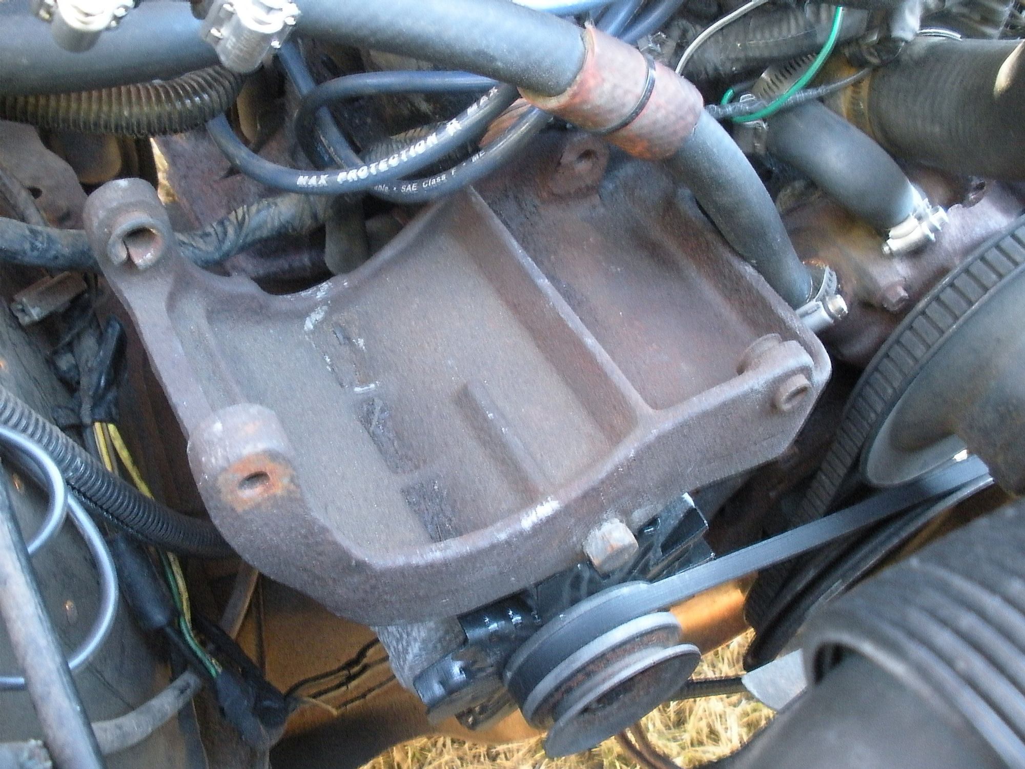

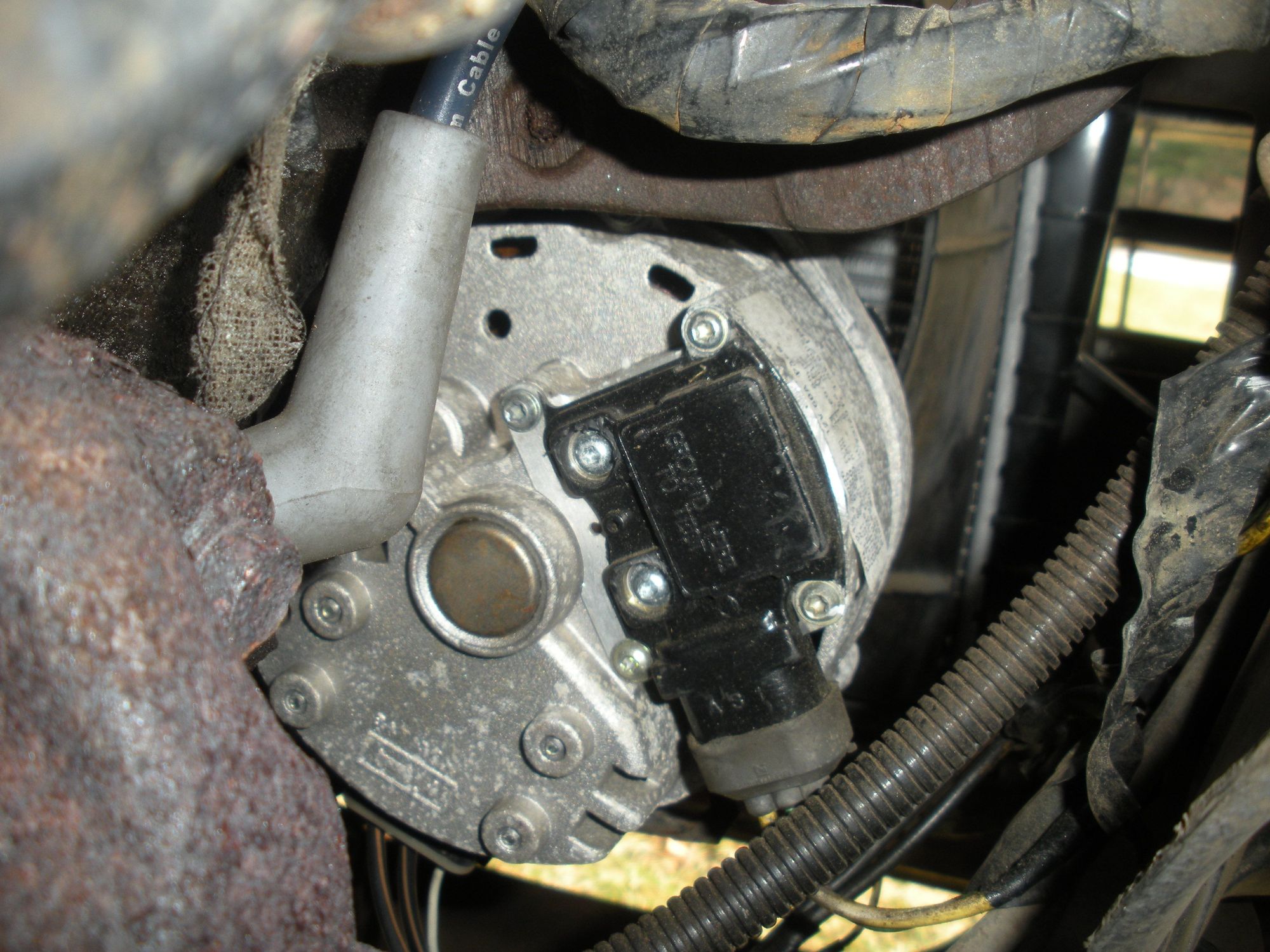

Agree, this is one thing you'll want to get locally. It also supports local businesses.
Also for future reference, it might be nice if you could put the truck info in your sig, so we know exactly which engine you have.
Here is the front and back of mine. I had my trusted mechanic replace the one that caught on fire a few years back.
