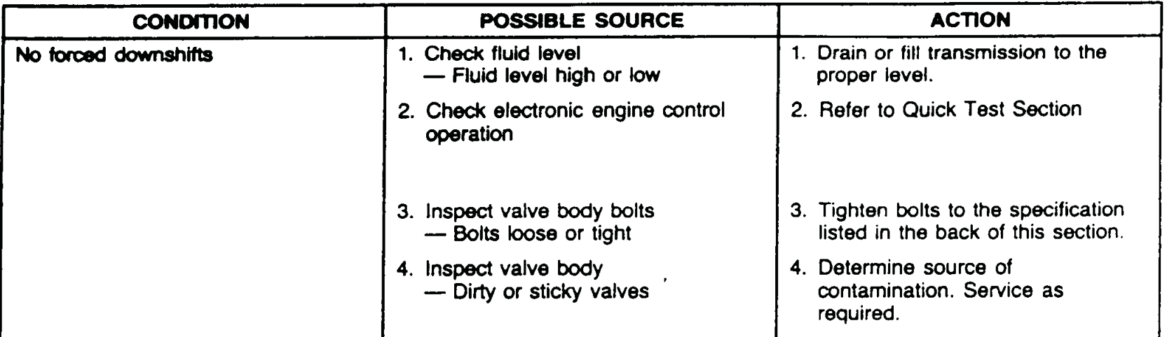

As an example, here are some trouble shooting tips that may help you from the ATSG manual:
