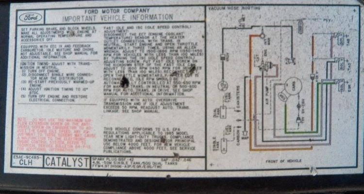

The vehicle it came from is relevant because a 1996 302 is different from a 1987(first year of FI, right? )
but that doesn’t mean they can’t be interchanged it just means it’s more than a drop in plug n play.
to find the original application of the engine is to find the code on the motor. Someone here may know how to find that.
to find the original engine for the truck, post your vin and we can find it OR you can look at your VECI label which has vacuum routings on it under your hood. Location may be on the base of hood by driver but i may be wrong. Your sticker you can post or just look at it yourself.
Maybe it’s on core aupport Should look like this generally
