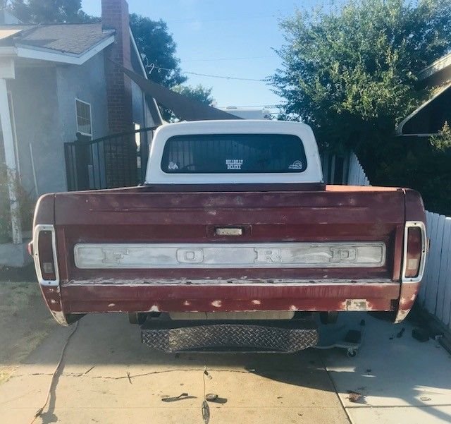

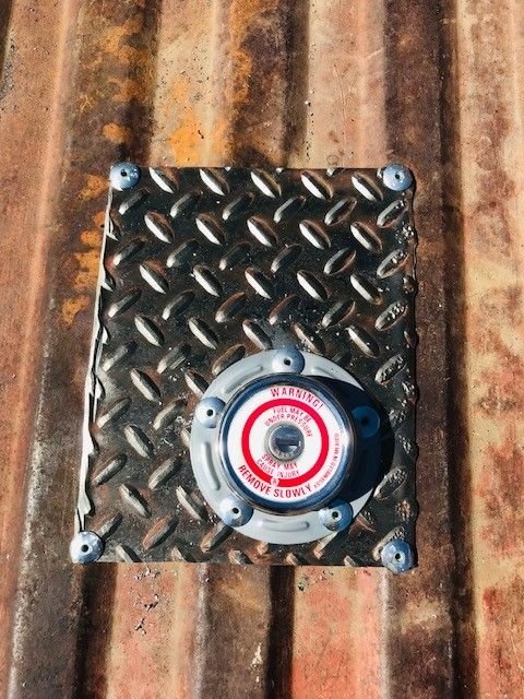

i did mine hillbilly style: i painted all rust with por 15 which was pretty minimal on the floors and none on corners. i had the farm bumper on it which was made with 1/8 steel diamond plate and i cut the ends off which i then used pieces from this to patch the holes in the floor, the cab gas tank hole, the new in bed gas filler hole and gonna use it to build the battery box under the hood cuz its crusty there too. i sealed it together using silicon and steel rivets then painted with por 15. it will probably out last me
i used this little bumper to tie the frame together at the end and to give a little protection to the new fuel tank or so my wife can put fuel in
its not fancy like a lot of guys on here but neither am i
measure once cut twice! i am gonna have an old aluminum shell on the bed so this will be protected from the elements
