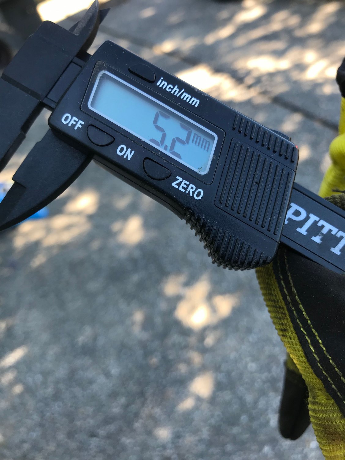

Drivers side rear came off today, no problem, a couple of light taps and it slid right off. Had to give it a little extra persuasion to go over the hub but no problem.
The drum was way lighter than I expected it to be. It has some pretty good wear grooves in it. Not sure how to tell if there is anything left to machine.
Pads are .2 inches or 5.3mm but also have some groove marks. From my research they are good down to 3mm but maybe it pays to just replace them. Can you buy replacements or do they need to be sent somewhere to have new linings put on?

There is a chance a brake shop can turn the drums. About all parts stores used to do it but that is fairly rare around here anyway. They can measure them and let you know what you have. You can buy rebuilt brake shoes. They aren't too expensive.

There is very little tolerance for machining the drums. If they're grooved then they might not be able to be safely turned down and you'll need replacements which are extremely hard to find. The shoes you need to have relined, as far as I know no one sells new or rebuilt shoes. I've had the ones on my F-2 relined a couple of times at a local shop which are also getting a little hard to find.
You may want to look into swapping in a newer rear axle, one from a pre'73 F-250. You'll have the advantage of having higher gears and.easier to find parts. For the front you can't install disc brakes. There a couple of places that make a kit.to.do it. I don't have the information handy but I'm sure someone will provide the name of one of the companies.
