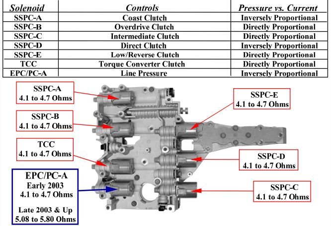

P0766 can only be set by a stuck shift solenoid D. Shift solenoid D controls the direct clutch, which is used in reverse, fourth, and fifth gears.
It is strange that you replaced solenoid D and there was no improvement. That should have fixed it. Here is a diagram that shows where each solenoid is located.
