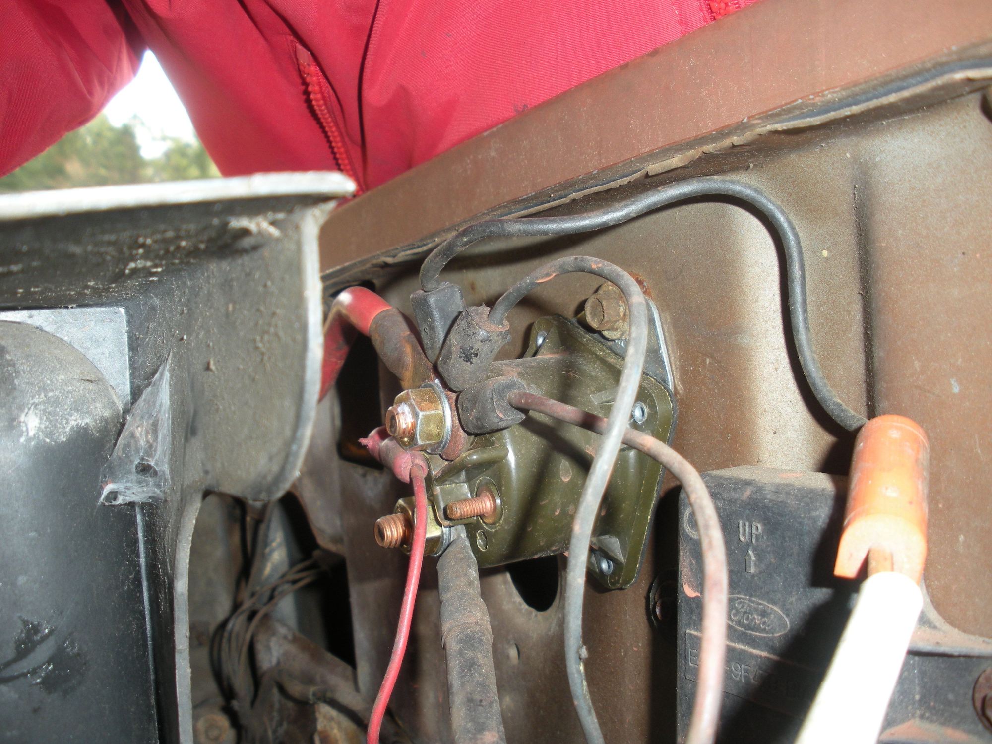

Here's my 86 F150 with a 302EFI.

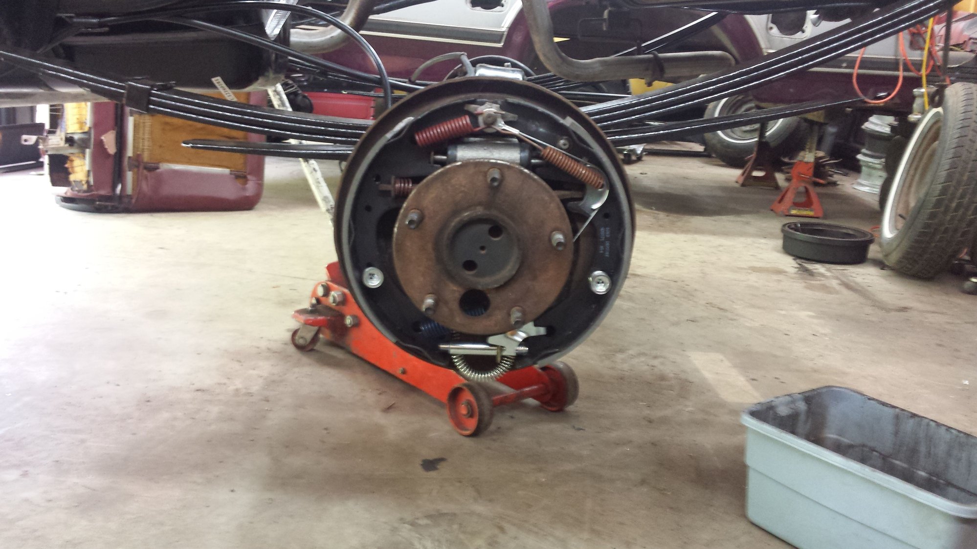

I the Ebrak cables to the wheels I replaced mine as part of the rebuild and I found the springs that push the arm back in the drums and pulls the cables where to long.
I could not get the drums on as they hung below where the drum would be.
I cut them to make them shorter so I could fit the drums on but I may not have made them short enough and they now may be coil binding?
I also had issues where even with the adjustment taken up all the way, the brake would not even get close to holding, pedal went right to the floor.
Thinking I had the wrong cables I bought a 2nd set and they were the same, just as long and long springs that would need trimming if I was to use them.
So I shorten the front cable by using a short pipe nipple looping the cable through it then to the adjuster and hooked up like normal.
I still think the springs are to long inside the drums keeping the cables from pulling the arms more as the adjustment is not on vary far and the pedal is up pretty high.
So if you get new cables make sure you check if the springs are not too long.
