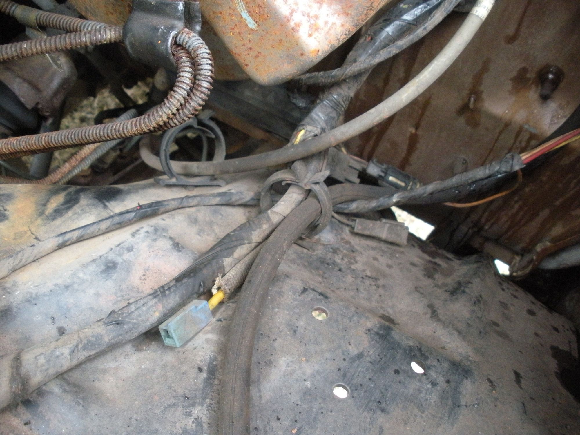

Hello
Does anyone know where these wirings belong to?
Thanks

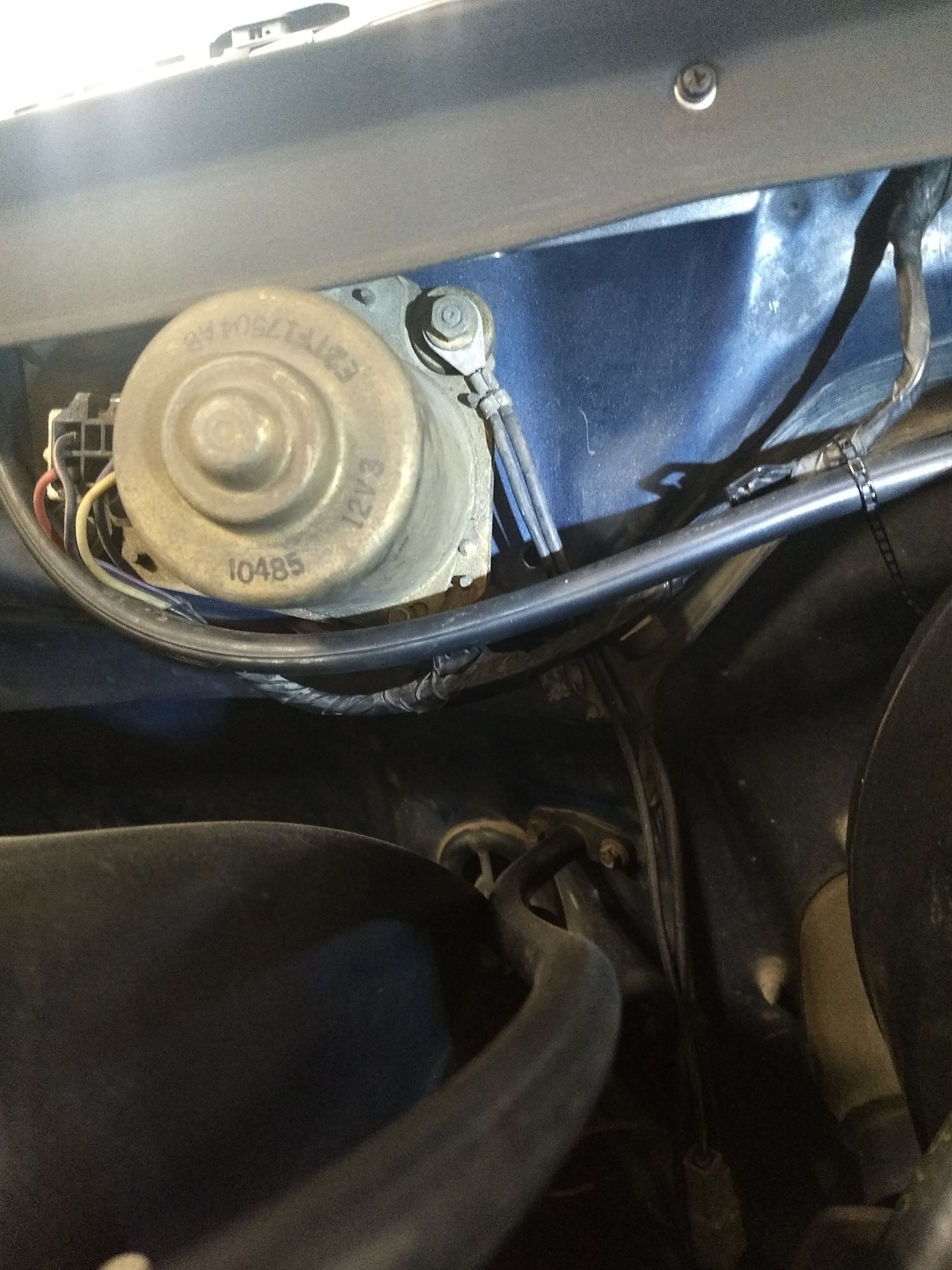

The black and bare wires are terminated at the connector in the lower, center of photo below.
They would have continued to the eyelet connected to the wiper motor for grounding. The other black wire at the wiper motor connects to the grounding lug on top of the intake manifold on your 5.0 L EFI engine.
I'm sorry, I can't help with the light green wire.

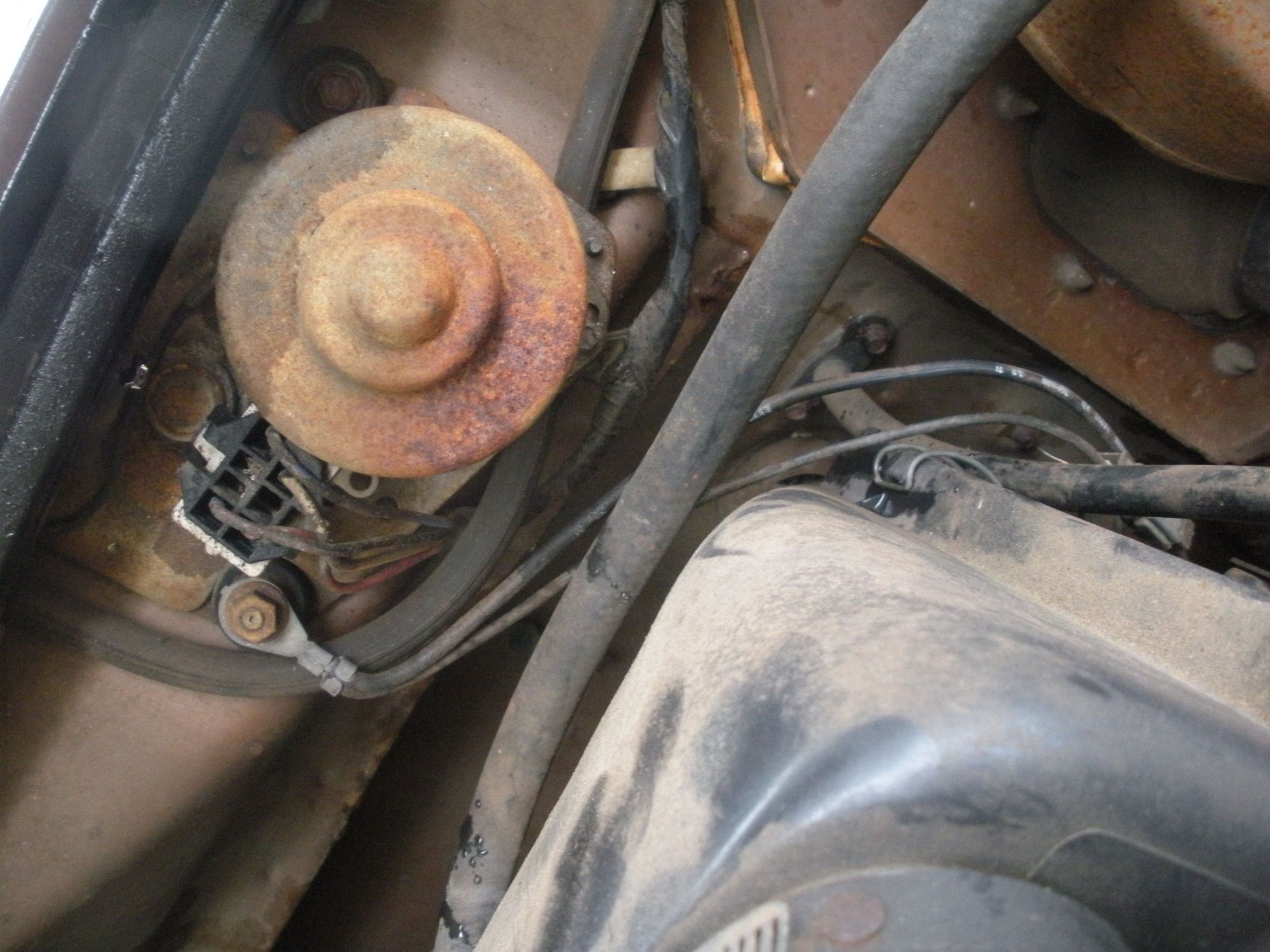

Here's my 86 F150, I think your green wire is from something someone added.
Or something your truck didn't come with from the factory.
