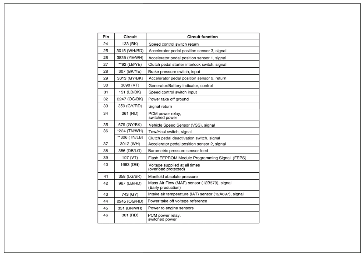

Does anyone know what this wire is for? It is the pcm connector closest
To the driver, orange wire with yellow stripe, looks like I had a rodent living under the hood. Have been having issues getting AE to communicate with the truck so I started investigating, once I get my AE back that I lent out, I will be able to test it after I fix this wire

Should be pin #6 ora/yel - PTO RPM bump

For future reference here's all the plugs. There is another orange/yellow trace wire but it is on the transmission plug.
