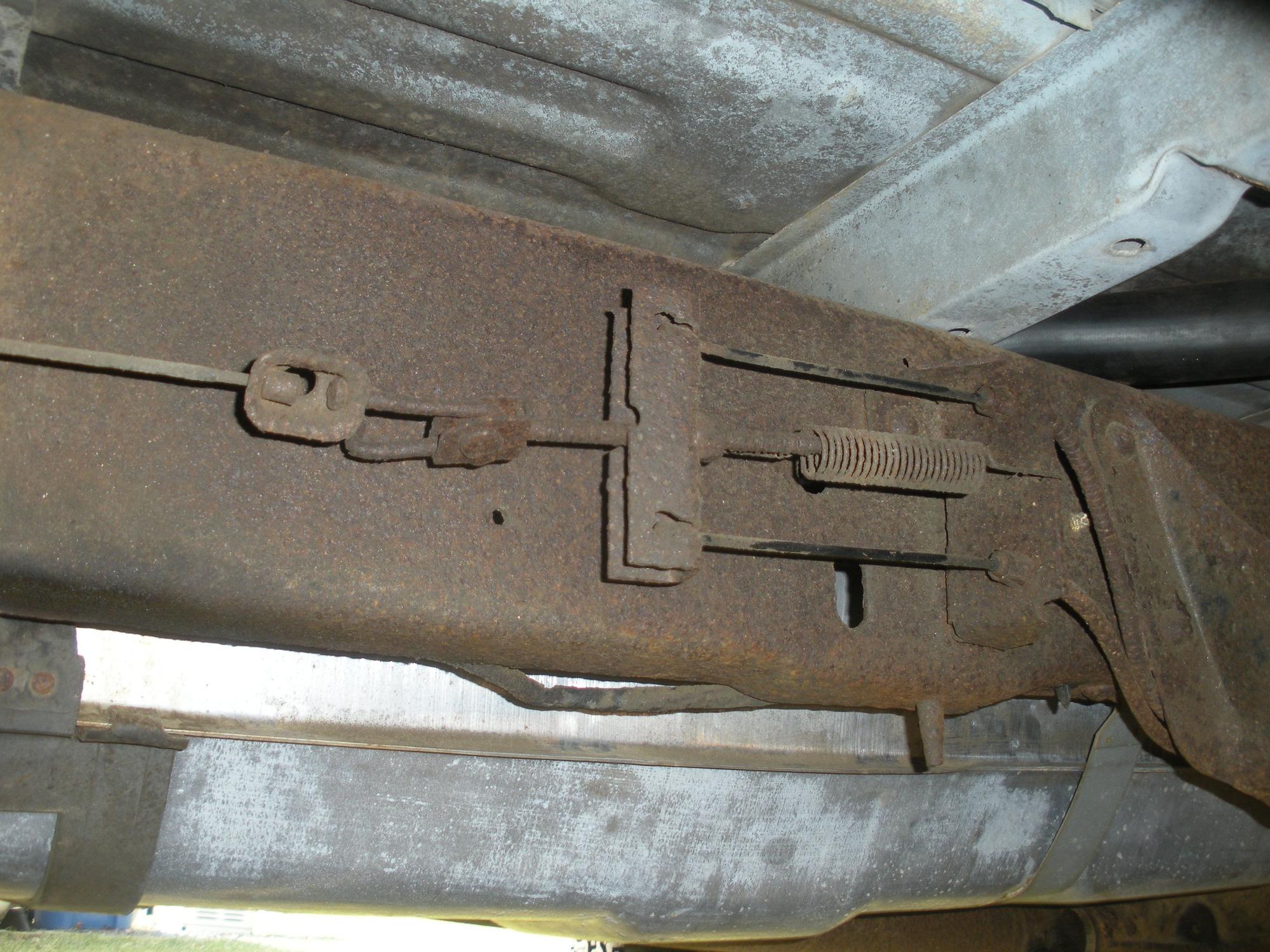

Ok so here is my next question. My parking brake engages and works on level ground, but does not engage on a hill. I know it engages the rear drum brakes to keep the truck in park. Question is, Do I need to replace the hardware in the drum brakes or the linkage cable for the parking brake. How do I test and evaluate? Again, thanks all for you help! I truly appreciate it.

Does the parking brake pedal easily go to the floor and the truck barely holds? If so, the cable needs adjustment. If it only goes halfway and has a lot of resistance, I would check the cables to make sure they are not rusted and stuck. After that you will have to take the back brakes apart and see what they look like.

So the pedal goes all the way to the floor. And I can tell that the cable pulls on the bracket and the spring. Those are not rusted and become loose when the parking brake is released. It was only on my driveway, which is sloped, that the parking brake did not engage. I forgot about just leaving the truck in gear to keep it parked as an option as well.

See in the picture below how the top cable moved but the bottom one didn't? Have you driven this truck any on the road? I suspect the bottom cable is stuck and the brakes on that side are getting hot. I would replace both cables. It's a very common problem on these trucks. Basically only one side is working.
