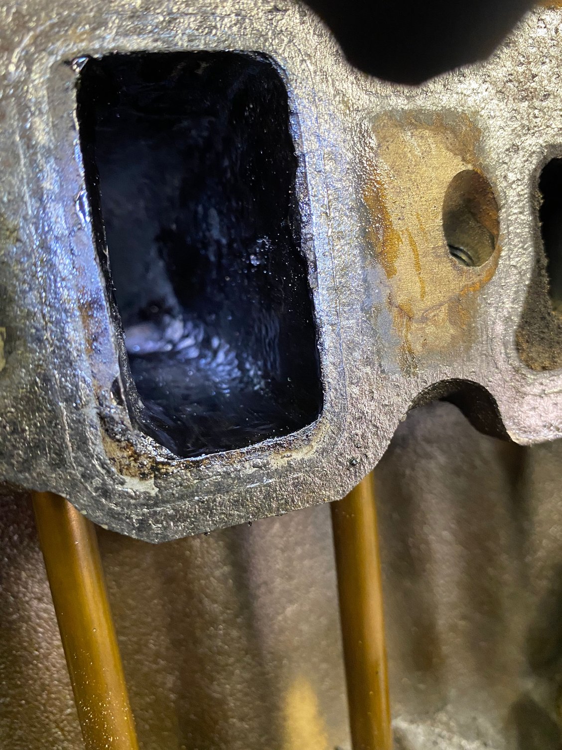

It has the short pigtail just like the 5.0. After looking at it, it should mate up just fine. I’m still pulling it apart and cleaning everything up before I put it in. I did fine some oddness though….. it looks like someone coated the intake runners on the heads with POR15 or something similar. I’m not really sure what to think of it. I’m putting new head gaskets and valve seals on, so I’m going to pull it apart, just debating if I should polish this crap off or not.
It’s a full roller motor, no doubt there. Here is the intake.
here is a bad pic of the runners
