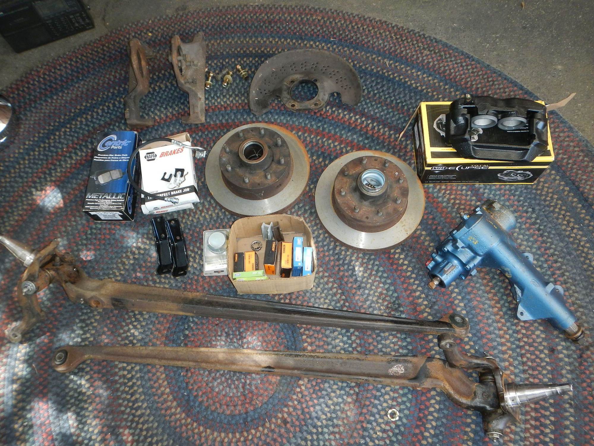

Old May 23, 2021 | 05:30 PM
lizardman1's Avatar
lizardman1
Joined: Jul 2007
Posts: 753
Likes: 133
From: Phoenix
I finally got to digging out the conversion parts. Brand new pin bushings and pins fitted and ready to install.
