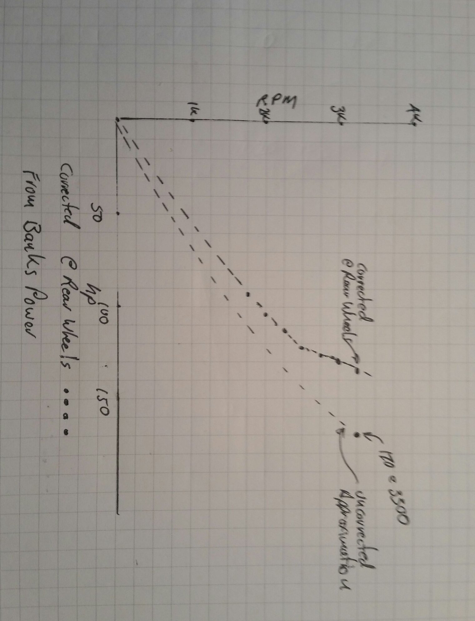

Yeah, 170 hp at 3300 rpms. I wouldn't be beyond trying less than 1200. Maybe 1000 with a 3.6 to one.
If you can find an rpm hp chart for the 6.9 you could dial in on rpm for 20+ hp and run that ratio. If it was straight line, it's not, you'd have 50 hp at 1000 rpm
Does anyone have a HP chart for the 6.9? Does it make 30hp at idle?
I found this data on banks:
https://official.bankspower.com/maga...ewinder-turbo/
I graphed it and tossed on an assumed uncorrected approximation.

Looks like 720 rpm with a 5:1...
That looks good, thank you! I will start at 1000MRPM and 3.6:1 and see how it works. Get that stable and turn it down from there.
