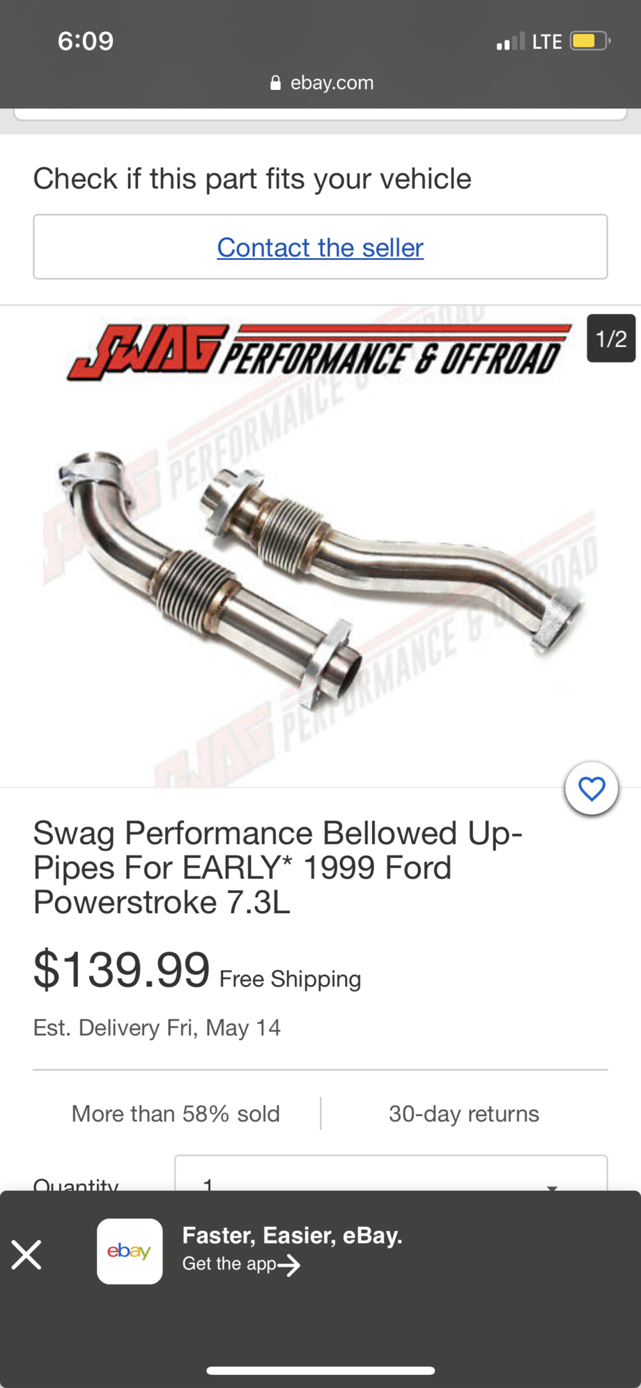

I ordered some bellowed up pipes. Do I use the gaskets or no? I’m hearing it both ways..
Never heard of not using the gaskets.
I used the gaskets on the 2 sets I’ve installed.

Where did you order your up pipes from? I was looking at blackhorse-racing and not finding just the up pipes - they have the whole kit with EBPV delete pedestal, etc.

Against my better judgment I ordered the eBay specials. Hoping for the best at least they’re easy to change if they don’t work LOL j/k.
A friend of mine is running the eBay up pipes and the fit and finish was great they’re working good so far hope I can say the same for these

I don't see the baby's butt and other Associated Hardware in that listing but I didn't open the listing from eBay. Your original babies butt won't work with bellowed up pipes

Oh no really? I didn’t know that. Thanks for the heads up! I’ll have to see if I can find the correct babies butt.
Edit: Anyone have a link for the correct collector I need for these up pipes? Thanks,

I just re read and see you have a E99. I may have posted too quick. Not sure how the E99 might be different.

Yep E99. I really wish it was a L99 or newer it’s been interesting to say the least finding parts for it.
Looking around nobody (including RiffRaff) sells new collectors in their E99 up pipe kits.. maybe my stock one is fine to use with bellowed up pipes.. hmm.
Not sure about the E99 stuff.
I installed a cheap Amazon set on my 2001 and an even cheaper $60 eBay special set on dad’s 2000. Both of them worked fine and came will all required parts.
I have read on here to be sure and try the baby’s butt fit to the turbo on the bench. Sometimes the fit here needs massaged.

Thanks again everyone!
https://www.thoroughbreddiesel.com/e73bup/
Towards the bottom it says costumer will reuse their stock collector. Maybe I’m ok here I can’t find a collector that isn’t the stock one anywhere.

Glad they say use the stock collector. Curious what it looks like as the OEM collector is a different design than the bellowed up pipes I'm familiar with. Also good the E99 uppies are only $140, way cheaper than before. Typically I'd say this is the moment to change over to late 99, but this might work out just fine.
And yes, dry fit all the parts on the bench in case some grinding is necessary.
