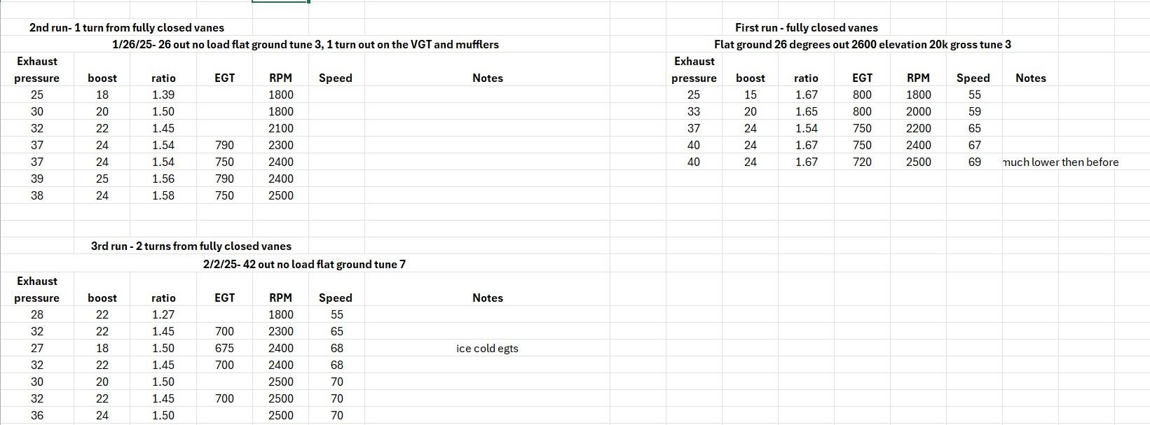

Turned it to 2 turns from fully closed. It definitely lost some bottom end compared to fully closed or 1 turn from closed. This is the recommended starting point from DPS. I am going to keep it like that for this trip. It is still substantially better than the old, fixed exhaust housing and is "safer" until I get the pushrods and valve springs in. After that, I will go back to fully closed or 1 turn from closed.
It appears to drop 2 psi of backpressure at 2500 rpm each turn.

I am successfully home from my 1800 mile road trip. The new VGT Turbo is AMAZING. It allows me to hold overdrive so much longer not because I lacked power but because I lacked EGT control. I could honestly almost throw my EGT gauge out the window and it would be fine. At 2k rpm I would literally burn the motor to the ground up a hill, so I would downshift to keep rpms up and now I can cruise at 2k rpm up hills at 1000 EGT near 30 lbs of boost. I could lay into it more but didnt as I am playing it safe from a valvetrain perspective.
For about 1500 miles of that trip I was around 20k gross. The other 300 miles I was just under 27k gross.
Since I am neurotic I didn't even push the VGT harder. If I saw 38 lbs of backpressure steady (Id let it hit 40-45 for a quick spike) I wouldn't push it further. I am really ready to get my pushrods and valve springs in now to push it harder.
