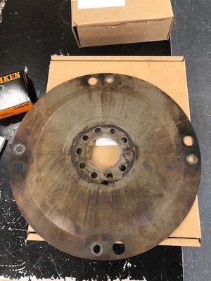

Just want to mention the old transmission had 406,000 on it before the rebuild. It was the flexplate that failed when the truck stopped moving forward. I had a photo of the flexplate but unable to find it at the moment. The center of the flexplate where the mounting holes mount to the crankshaft cracked all the way around separating from the rest of the flexplate. I never seen or hear of this happen before. The Flexplate was 9 years in service. Along with the rebuilt transmission I had the new bellowed up pipes installed and they are worth the money. What a difference. A new rear main seal was installed. At 411,000 miles the truck and engine are still running strong. Thanks Again,
The type of flexplate failure you described is likely the more common type of failure found in flexplates, but still, we would love to see the photo of your carnage, as they are always instructive, especially when it matches our application here.
My guess is that the flex plate flexes, and arguably the area of greatest stress is the junction between where the flexplate is constrained (by the circle of bolts into the crank flange in the center) to where the flexplate suddenly unconstrained (free to flex). The bolt circle diameter where the flexplate bolts to the torque converter is larger than the bolt circle diameter where the flex plate bolts to the crank. The larger bolt circle diameter has some inherent advantages over the smaller bolt circle diameter in distribution of stress. Compounding this is that the torque is delivered from the crank, straining the plate to over come the inertial resistance of the rest of the drivetrain down to the contact patch of the tires, so the sudden transition between constrained and unconstrained at the crank bolt circle diameter is challenged by both axial and radial forces and resistance, which the flexplate resolves by flexing. Until it cracks.

Yes, Sir....That's what the old flexplate looked like.

Was the plate/washer/doohickey with the curled edge that goes between the bolt heads and the flexplate missing?
