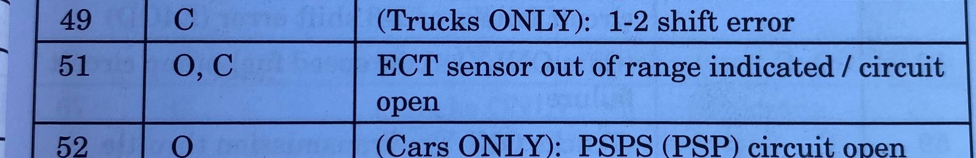

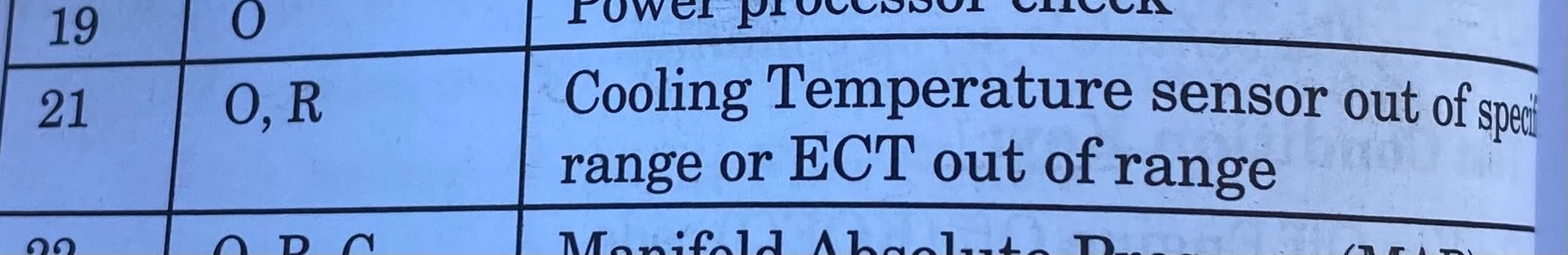

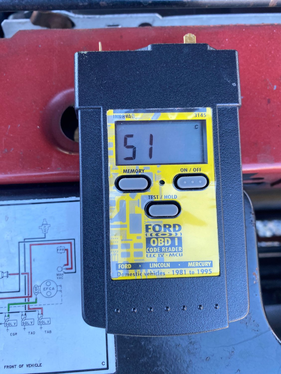

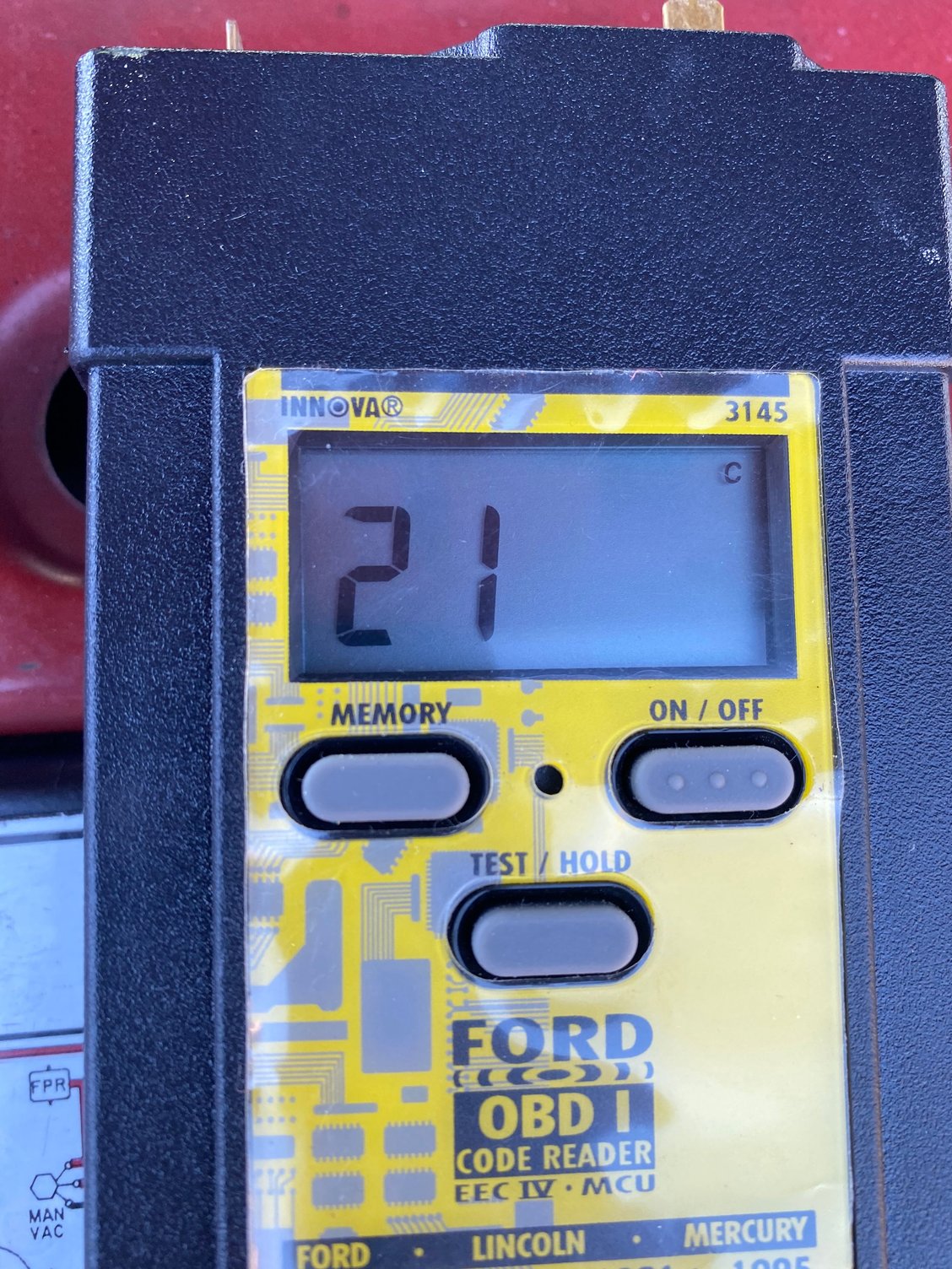

Also, cleared the memory by unhooking the battery earlier and turning on the headlights for a minute or two. Ran it for codes after driving it. Codes 21 and 51 for an ECT sensor fault. Should be the sensor near the thermostat housing, not to be confused with the temp sender for the guage cluster. This could also be sending the ecm a weird signal that would screw with something?

You will get a code 21 if you pull the codes before the engine is fully warmed up. Code 51 means the temp sensor was disconnected. Did you mess with the sensor while pulling the codes? I would let the engine fully warm up and then try again.

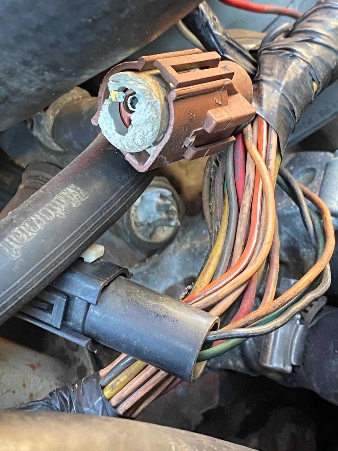

This all did start yesterday, after my foot slipped off a step stool i was using to lean over engine bay. Cursed a bit, and grabbed onto what i could, and in doing so bumped my injector turning it which was what i believed caused my starting issue. Maybe i hit the wire for the sensor as well? I’ll double check that too tomorrow morning

Turns out it broke in half!
