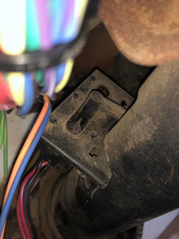

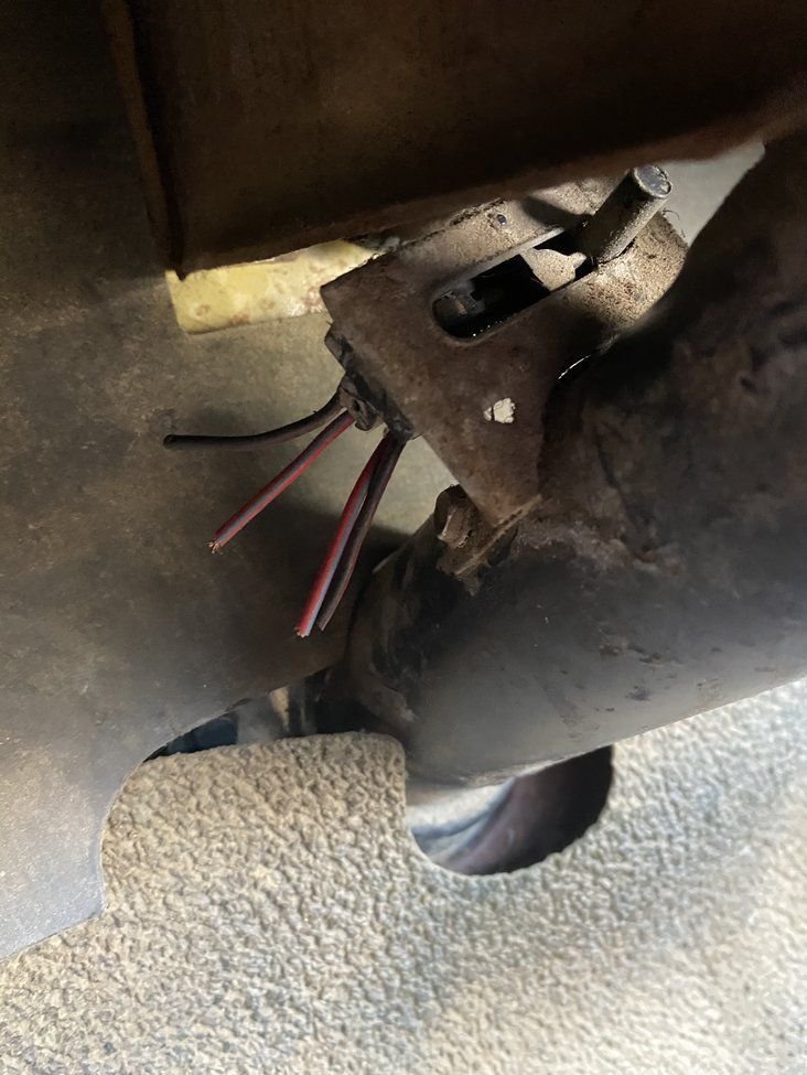

X2, when you get a no nothing at all issue. Honk horn and check if headlights come on. I bet they do. So ok so you have 12v at battery. Time to make sure you have it in park and the NSS is working not broke /loose. Yours should be under the dash and on top of the steering column.
This one is missin the tab to move the switch plunger.
This one has the tab.
