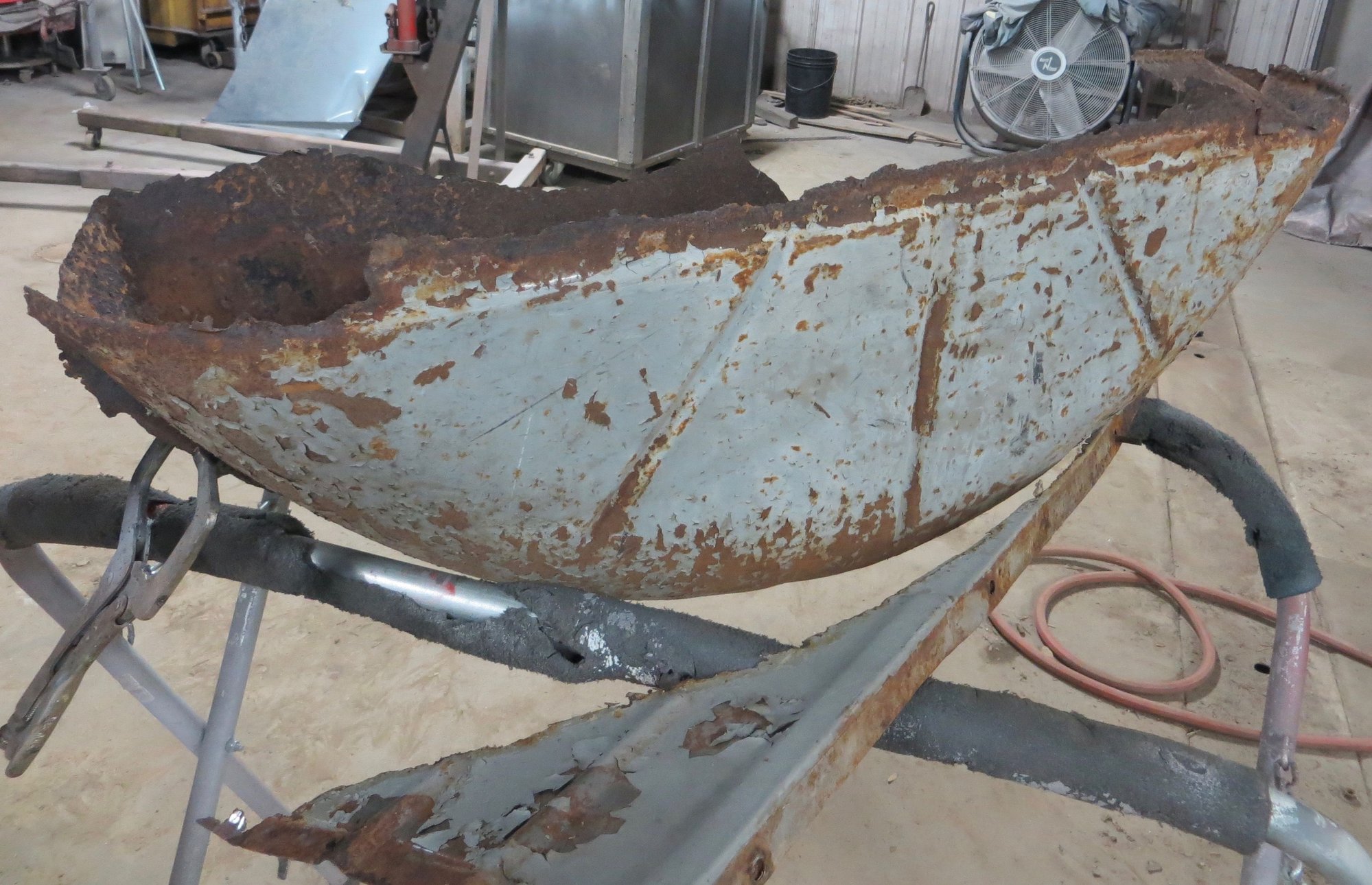

I'll second EBEAR. I used JB Weld and brazing to "repair" my wheel arches and tubs. And believe me--what I had was rough:
I purchased replacement parts and was all set to commence with major surgery, but in the end, didn't pull the trigger and opted for a faster cheaper "temporary" fix. I'm four years in with the repair, and so far the brazing and JB Weld are holding up. I always expect to see rust bubbles coming through, but so far so good. Good luck.

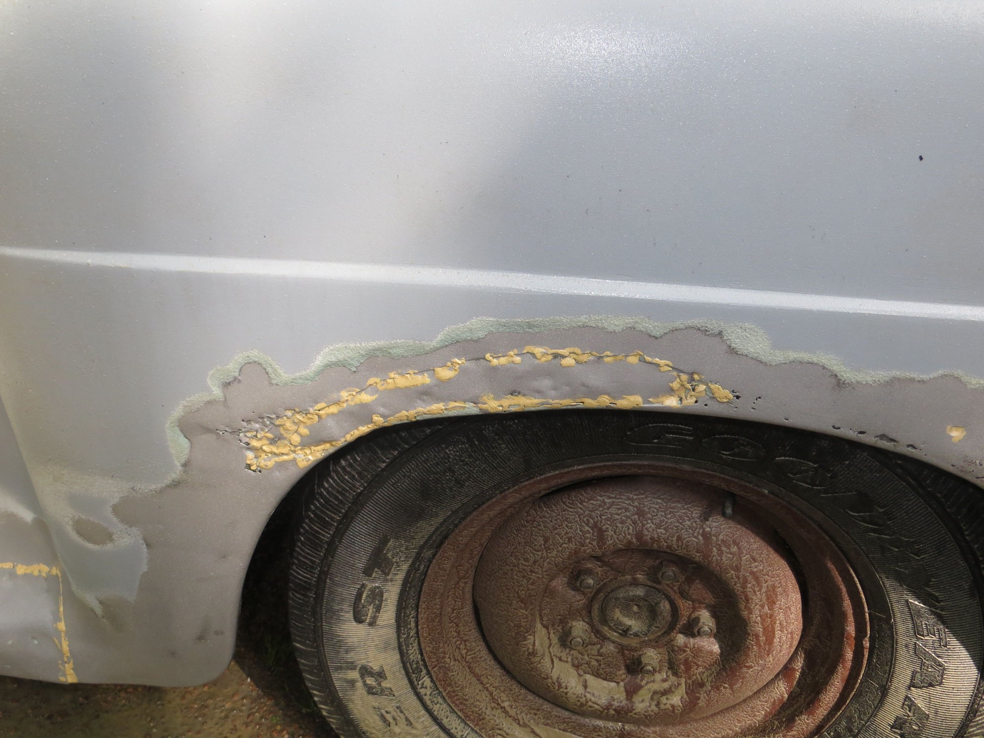

Here's another pic that shows what some of the areas were like that I filled in with JB Weld:
Innitially, there was just body filler over the brazed repairs and rust bubbles did come through--and in less than a year. I blasted these areas, epoxy primed them, and used JB Weld for filler. It's been holding for four years, but as mentioned, I do have the parts stored for a more permanent (and costly) repair should the need arise.
