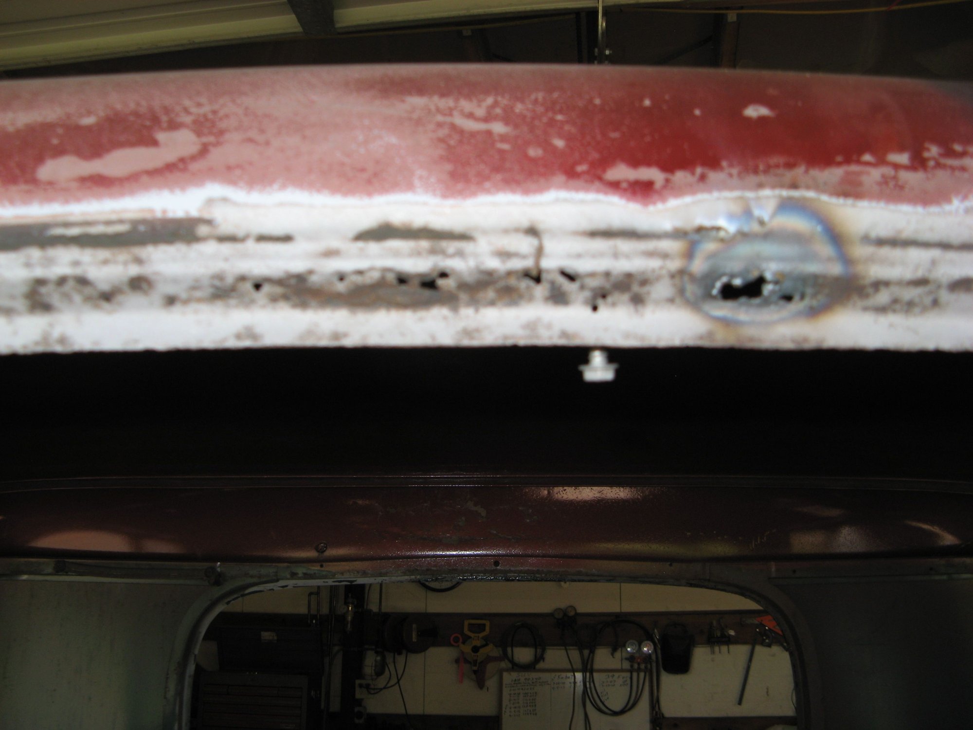

Windshield lip rust
Windshield lip rust
what do you all think any way to fix this without cutting out and welding in a new piece of special bent metal

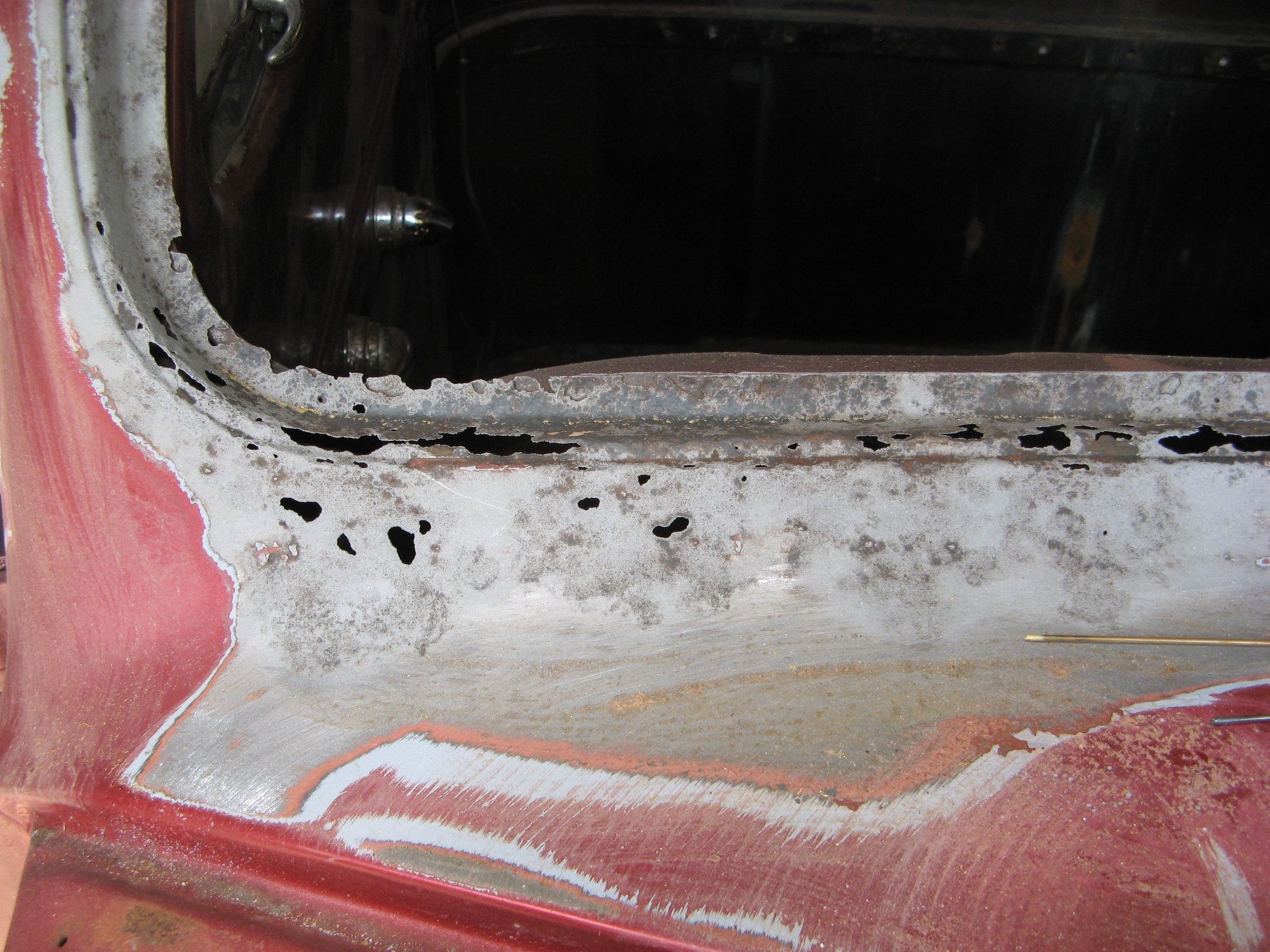

I had this same problem except way worse. I sand blasted the area both sides then brazed it all. Ground the brass down and the window gasket and window fit and seal perfect.

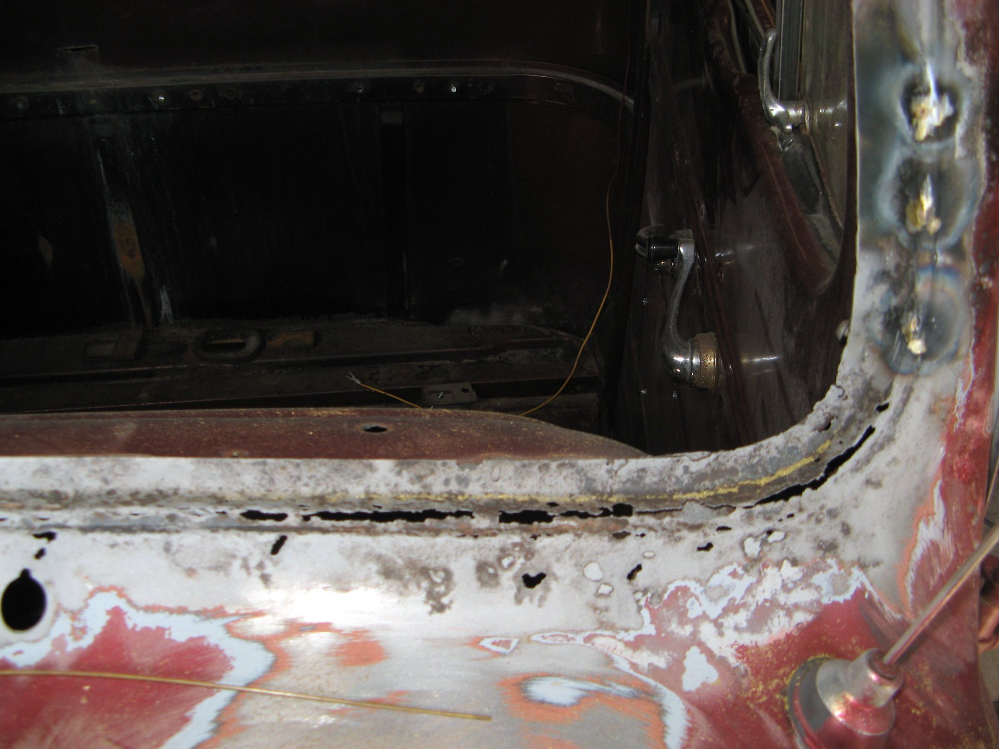

I found another picture of the area top center of window frame that I braze repaired. You can see where I started the repair by trying to gas weld it with steel which did not work. The thin metal melted
away before the weld rod would melt putting way to much heat into the surrounding area. This is on my 1949 F1.
