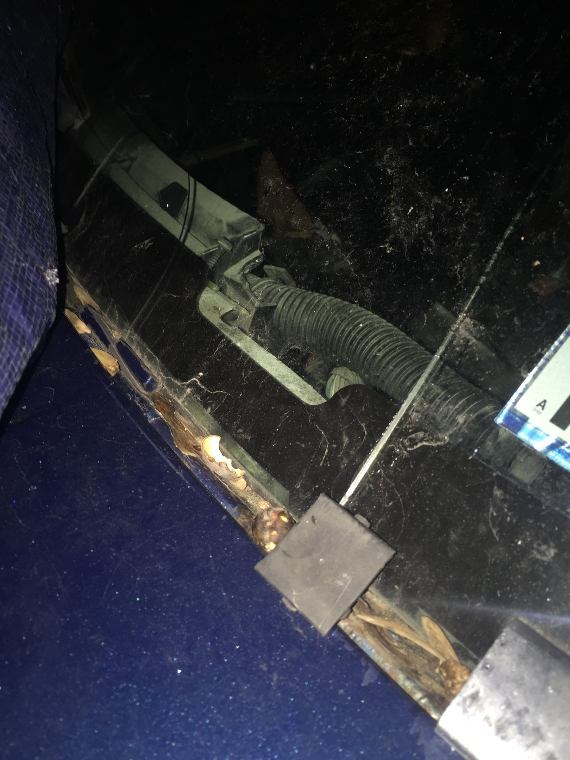

Here's the first bit of rust. It's right where the windshield meets the grated panel that sits between the hood and windshield. Usually the chrome weather stripping would cover it up and out of sight. My prediction to fix this is two ways depending on time available/costs.
#1 My first and best option to fix it is to have our windshield guy remove the windshield next time he's at the shop doing someone else's vehicle and then once it's removed just wire brush it down and hit it with some naval jelly and then prime it up and just have him install the new windshield next time he's at the shop doing someone else's windshield.
#2 Is the more realistic of the two options unfortunately. I'm gonna have him do my windshield next time he's at the shop but just quickly wire brush the rust and hit it with rustoleum or por15 then have him install the new windshield same day.

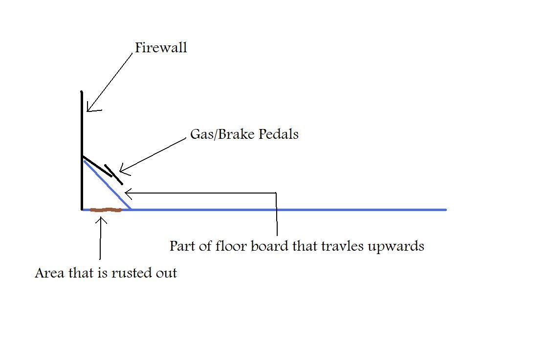

The last bit of rust is the floor boards...but not the actual floor boards, just the cab sheet metal that lies underneath the rising floor board of the front driver and passenger side. The picture below is to give y'all a better idea what I'm reffering too.
To fix this bit of rust I was going to cut out the part of the inside floor board by the pedals that slopes upwards, cut out any rusty areas and weld in new pieces of sheet metal from where I cut out then weld the sloped inner floor boards back in all after painting the newly welded areas with some type of paint.

I would plan on removing the driver from cab support to fix it Correctly. Then you can cut out the bad spot of the floor and paint the repair. Then you can install a new cab support
I plan on doing all the cab bushings anyways so will see just how extensive the rust is on the supports once I get it in the air and off the frame but I recall the supports being relatively clean (minor surface rust no rot)...its just in between sheet metal seams that are starting to go really
