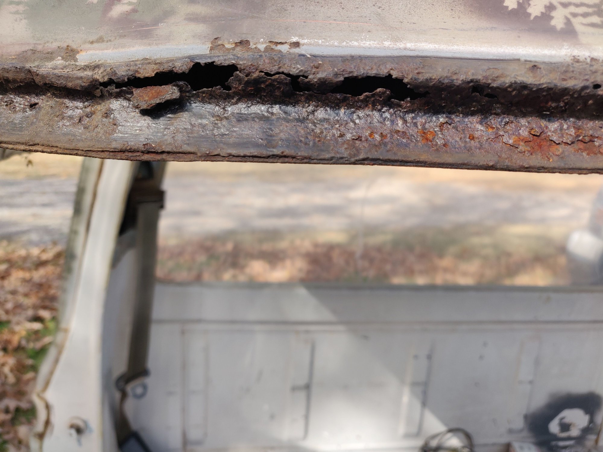

Hey everyone,
Just removed the windshield on my parts truck and was hoping to use this cab entirely as the donor. How difficult of a repair will this be to patch up?

There are several recent threads on this here you might search for that could help you. it can be fixed but it's not a fun or quick job. lots of cutting and welding that's the only way to do it right.
not sure where you're at but solid cabs are cheap around here that's what I'd do if possible.

What the condition of the cab you have now? Hard to imagine that it is worse off than this donor.

I would hate to have to deal with that and my limited welding ability. What part of the country are you in?

Plenty fix there issues but is work ,,look here https://www.ford-trucks.com/forums/1...ld-you-do.html and many post here on this site
