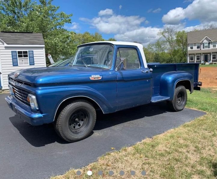

Hi all,
I have a 1963 f100 (4x2) with a 292 and I am looking into replacing the front leaf springs which are pretty well shot. My question is are there any options out there to get the front end leveled up a bit. I am thinking it needs like 1-1.5 inch lift. I see a lot of people lowering the trucks but not much on lifting. The parts manual appears to show the F250 springs as being the same length and thickness but having an extra spring in the pack. Has anyone tried using F250 springs on an F100?

Leafs are easy, your spring is over the axle so if you need the front up an inch, make a 1" spacer block

https://www.generalspringkc.com/1961...ring-6-leaves/
I would check with this place, I'm sure they could add springs to the pack to raise you up..

If you have the space to do it remove the springs and take them to shop that specializes in rebuilding/re-arching leaf springs. They should be able to do a custom arch much cheaper than new springs.

Dang! I only WISH my truck sat that low! I would say I'm at least 1-1/2 inches higher.
Maybe we should trade springs...?
