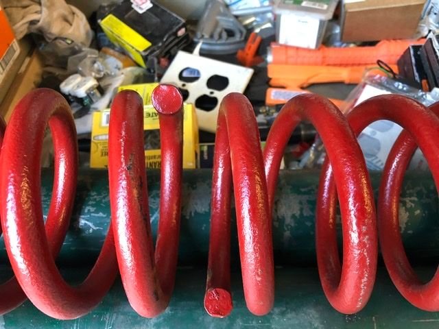

Front springs
Mine is a 66 but to show you never know what you are going to get one of the PO replaced the front coil springs and they are different. Probably
Notice the coil thickness. I noticed the passenger side was a bit saggy.
one v8 spring and 1 6 cyl spring.

Passengers side should actually be slightly larger diameter coil than drivers side to offset the torque rotation of the engine. They also often used a shim on the passengers side below the lower coil spring retainer.
C5TZ-5355-A - SHIM - FRONT SPRING

Interesting. The replacement springs are the same thickness.
