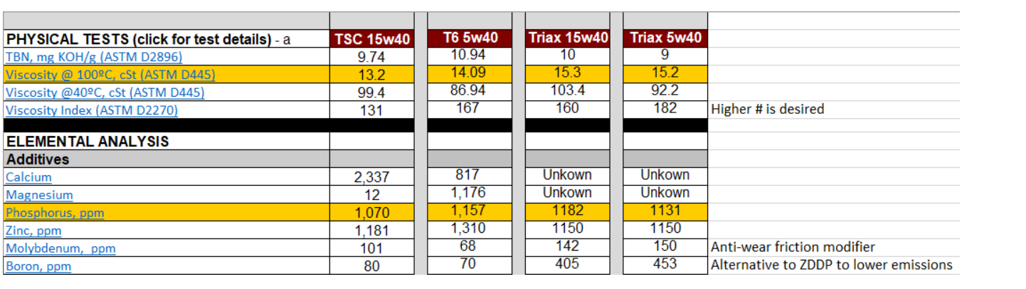

On January 13th I inquired to Triax about why they claimed the Fleet Supreme 5w40 was a better oil than the Fleet Supreme 15w40 and this was the answer I received.
Originally Posted by George from Triax
The 5w40 has more PAO, lower pour point and better fuel economy. The VI index is higher on products with lower pour points. Both products would be a great choice though. When at operating temperature, both products are a SAE 40 however, so in that, they are equal.
Thanks,
George
I had to look up PAO, it is an acronym for Poly Alpha Olefin
Originally Posted by Google Search for PAO
Poly Alpha Olefin or PAO is a 100% synthetic base oil stock used in the production of high performance lubricants. PAO's typically have a higher viscosity index than mineral oils and better oxidative stability and are less likely to breakdown.
Quote source: https://www.ford-trucks.com/forums/1...l#post19676570
Now, why they would list both oils as full synthetic and under the same label as Fleet Supreme and include a different blend of additives, I don't know. There is a lot of information including elemental analysis on the oil in this thread, but here is a short snip of some of the facts involved presented by Triax, Rotella and TSC in a table that I created using Excel.
Table source: https://www.ford-trucks.com/forums/1...l#post19676567
