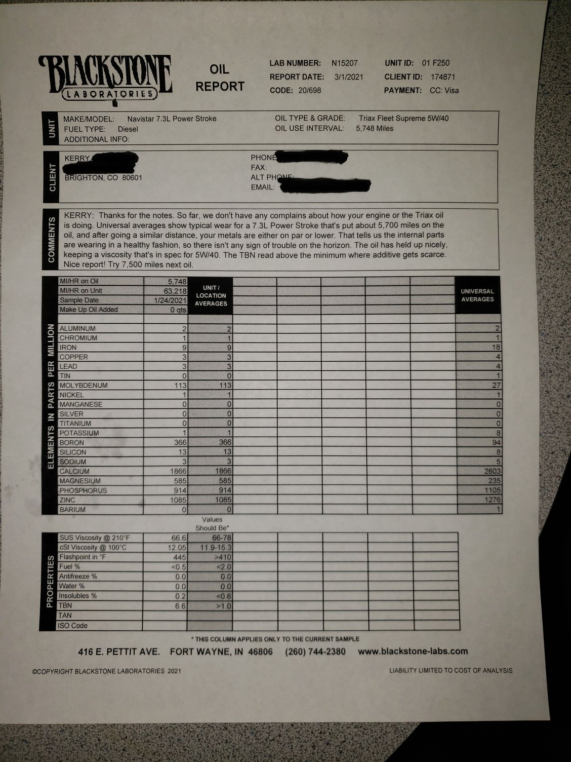

Got my Triax analysis back from Blackstone.
I will probably keep changing oil between 5k-6k miles
​​​​​​​Let me know what you think.

Very nice report. Gives me some confidence that my run will have zero issues. Thanks for posting it up!

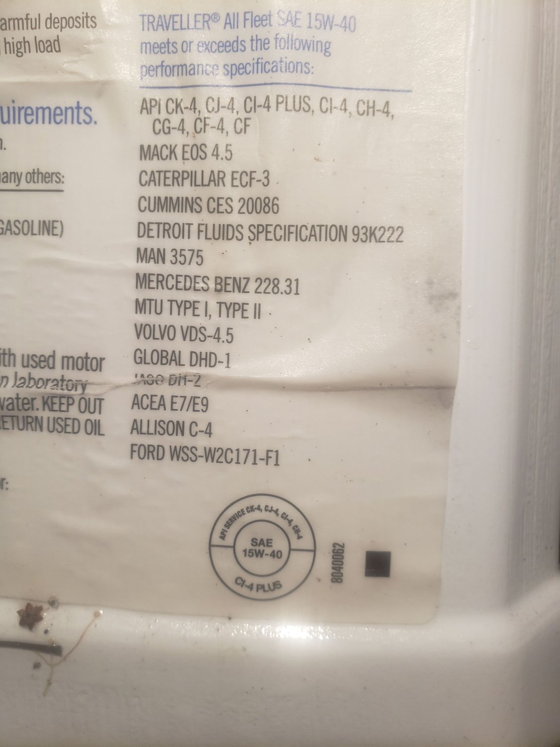

I just took a photo of the back of the traveller 15w40 I just used. I think this is the new stuff as I when I bought it there was was one bottle of CJ4 and the shelf. I bought this in Nov 2020. But to be safe,, look at the back of the bottle as they might get different batches from manufacturers. I think you could have potentially been looking at old stock. Also, I did a mini Armylifer and bought 20 gallons as it was sale at the time.

That's the same as the stuff I used in my truck, but more recently when I was in there me and my buddy couldn't find the Ford spec on the stuff they had in stock. Its possible I missed it, but I'll be in there soon to verify. Like the Triax guy told Sous if Volvo likes it then you're good to go but I thought Volvo was missing as well. I may be making something of nothing though and be wrong on both counts.

Thank you for jumping in here with an image that provides some evidence that the TSC branded oil is still in fact on each of the certification lists noted by BA86f250.

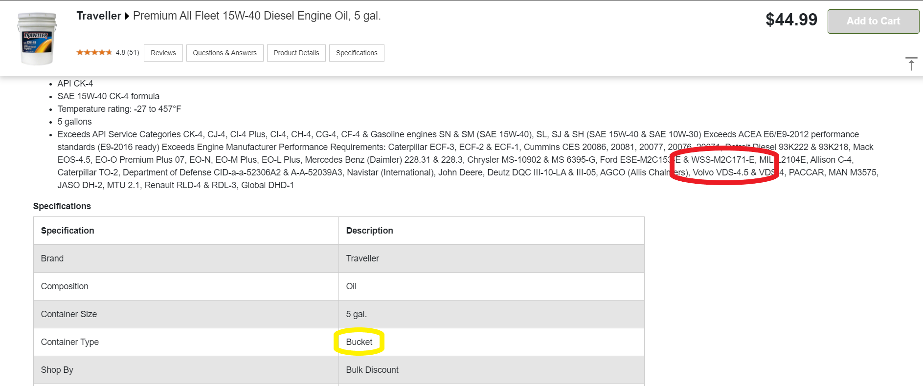

As of 3/5/2021 on the Tractor Supply Company website, the Travelers 15w40 "pail" has the following certifications noted for it. I have circled the Ford WS and Volvo certifications in red. I would also like to point out, that this is a "pail" of oil as described by 1-800-CAL-LWES (running joke created by ESwift about me being too weak and uncoordinated to lift a 5 gallon pail) and NOT a bucket.
Again, not to say you may have missed the information you were looking for on the bottle, but maybe you are the first to see it wasn't there. Why wasn't it there? Perhaps they have stopped printing it on the bottle, which is unlikely. Perhaps you saw some old stock, we know that happens still based on another recent oil thread. Perhaps Travelers fell off both certifications lists, but I see that as unlikely as well in my unscientific method of analyzing the details. I am very interested to see what you find, or don't find for that matter.

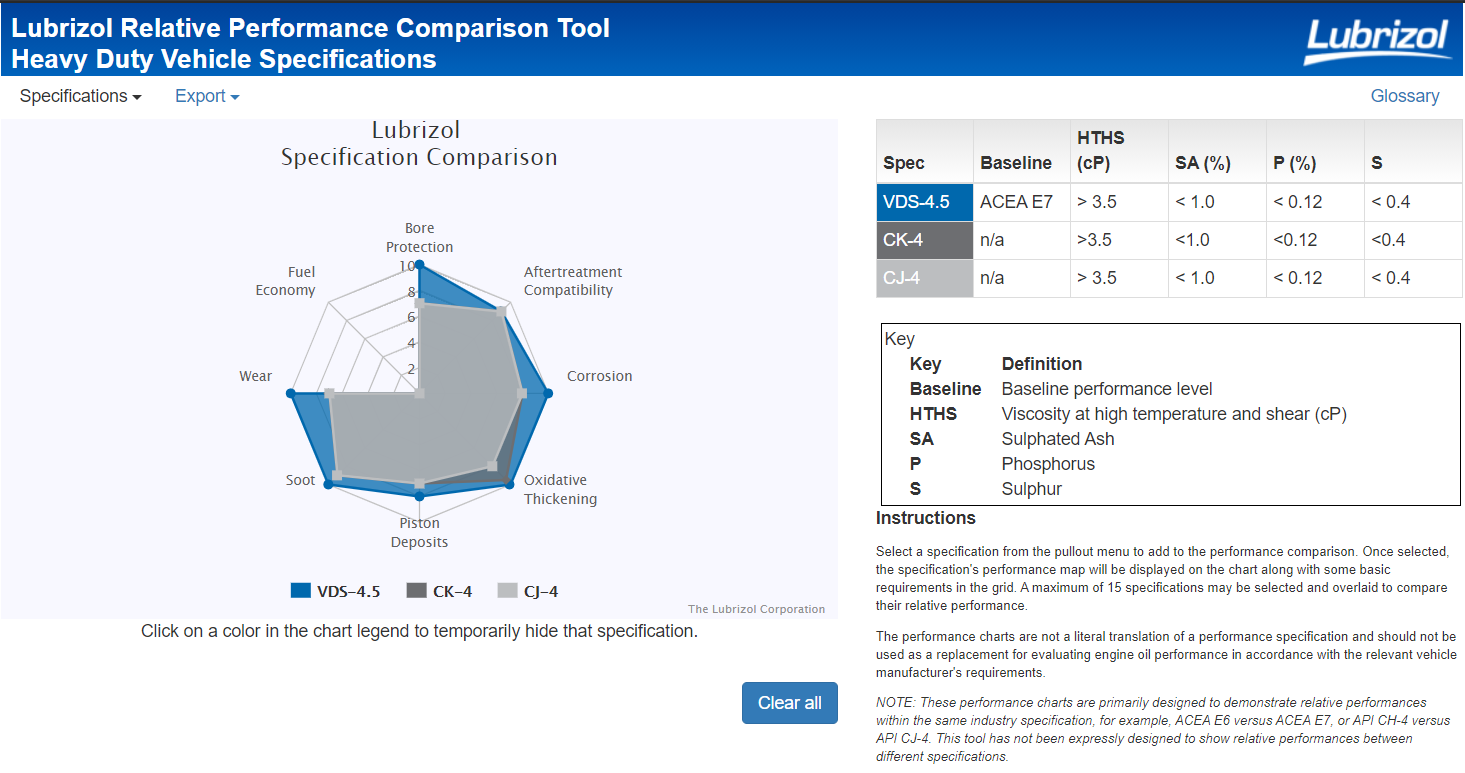

Recently I looked into the Volvo VDS 4.5 certification as to why it was considered the gold standard within Triax. Frankly, I had never heard of it until it was brought up in this thread or another Triax oil thread, I don't remember that detail...
It is very difficult to find information about certifications and 3rd party analysis if you are not embedded in the industry. I gave up after a while because I had other tasks to accomplish in the end, the Volvo VDS 4.5 doesn't make any difference to me, so I went along with the link that Triax provided to a friend of mine named Jake (FTE name Khan).
Using the link that Triax provided to Jake and Jake shared with us a while back, I was able to easily manipulate the certifications in order to place them in an easy to read format, as you can see below.
Image source: https://online.lubrizol.com/relperftool/hd.html
