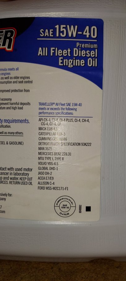

Sous I made it over to tractor supply and I took these 2 pictures of oil on the same shelf:
Not sure which one is up to date but they both have the Volvo spec so I guess I was mistaken on that.

Thank you for following up! I drove by TSC on Saturday when I was going to pick up some junk tires to sink in the pond, but didn't stop to check out the bottles. A friend of mine in TX that was following this thread sent me an image of a 5 gallon pail he bought several months ago with the Ford and Volvo certifications. I didn't post the image here though as there was a chance you were right.
Again, thank you for following up sir, I and many others appreciate your contributions to the thread and the community as a whole.

The VDS 4.5 is the newest specification and from our friends at Triax, the standard of all standards.. Also, the CK4 photo shows the ford specification. This stuff appears to fine to use and it just went on SALE. I run the stuff for 3000 miles and for a little over $40 dollars for an oil change, the motor is clean and happy. Also, the oil it not pitch black as when I ran the expensive stuff out to 5000+ miles. From some older research, this appears to Martin Lubricants Xtreme Fleet oil. Very similar to WM supertech from Warren and Napa oil from Valvoline. Just good basic oil that I would not run out extended miles, but still protects your engine just fine.

I ran both TSC oil as well as Supertech under "severe" use, by their definition. They both performed well according to a UOA and I would not hesitate to use them again if I had to. I just didn't like the gas engine rating added to it and decided to give the Triax a run, but the Travelers is not a bad oil at all. I ran mine out to 5000 miles before doing the oil analysis and it came out stellar.

We have been through the "gasoline oil" rating before in another thread here: CK vs CJ oil
I may be mistaken because I don't know for sure what BBSlider001 meant, but the "gasoline oil" he referred to above is probably pertaining to the API rating of SN as seen in the image below. Coincidentally one of the bottles was bought and pictured by cclgeo, who also posted just above. Thank you for that sir, we do appreciate it and your efforts to provide factual information to the community.
The meat and potatoes in the long and drawn out thread riddled with rants and facts is that the API SN rating is what sets the amount of ZDDP to 800ppm or less, among other things. Although, the newer CK-4/Ford WSS-W2C171-F1/Volvo VDS 4.5 rated TSC does NOT have the API SN rating as seen below in the image provided by ArmyLifer. Believe what you want to believe about the oils out there, but I am going to go by what is printed, published and verifiable by the manufactures of the various oils and institutions/manufacturers such as the API, PQIA, Ford and Volvo.
Bottom line is run whatever makes you happy, just be able to wade through the BS and misinformation of internet lore in order to make an informed decision about your choice of oils.

Thanks Sous, you are correct, I was a part of some earlier conversations about traveller oil.. i thought i found gold,, but according to the group, the CJ4/SN was not good. So i returned it and got the CK4 without the SN. That is what I have been running and the injectors love it so far. So, I agree with you, the oil i buy from now on will not have the SN in the circle. That is becoming hard to find as most of the big oil providers have changed, but rotella is standing strong with just CK4 rated oil as well as the travellers. Im sure there are other over the counter oils vs exotic ship to door type oils like Triax and Shaeffer that are just CK4 rated (no SN), but very limited at the big parts stores from what I have seen.
