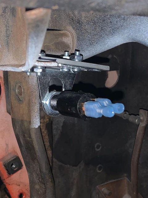

Literally just did this. A hack saw and some scraps I found in the shop. Biggest obstacle for me was the neutral safety switch. Without that in the way the possibilities are endless.

Thanks for the picture. It has given me some ideas. Is that angle iron that you used? How close is that to the NSS? I have a hacksaw. No vise and only hand tools the bend. Thanks.
The flat stock bolted to steering column support almost touches NSS. Then, a piece of angle iron bolted to it and another to the brake pedal arm.

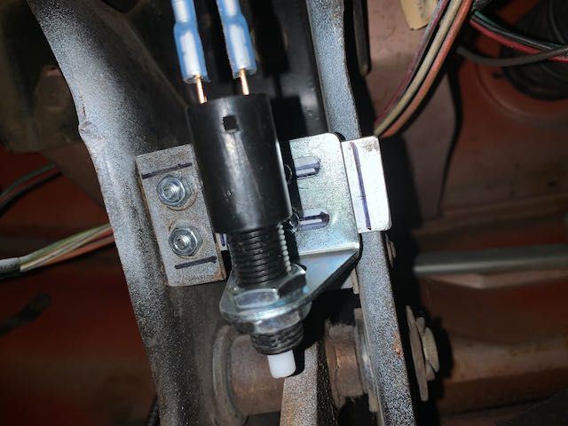

Update
Just wanted to give an update on how I attached the switch. Hopefully the pictures make sense. There was an L-shaped bracket spot welded to the left hand side of the brake pedal assembly. Not sure what it is for. I attached a strip of ⅛" x 1" x 3" piece of aluminum to it and then attached the bracket that came with the switch to to the aluminum. And then lined the switch so that it will hit the brake pedal arm. I need to still attach the the rod from the power booster to the pedal and then it will push the switch into the pedal and close it. I need to adjust it a little. No metal bending. Just metal cutting with a hacksaw.
